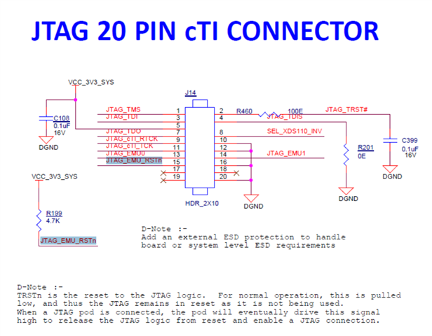

When debugging AM2434 with the XDS110 debugger, the customer plans to use the CM10 (ARM 10pin) connector. In this case, they would like to connect pin 10 (nRESET) to pin A5 (MCU_RESETZ) of the AM2434 to enable system reset while the power is on.
Do they need to insert a Schmitt trigger in the circuit, as is done on the evaluation board ?
If the nRESET is connected directly from the XDS110 without a push button, are there any reference designs or connection examples available ?
(Pin B6: TRSTN is planned to be pulled down.)

    Since EMU0, EMU1, and TRST have different meanings that direct device boot and behavior upon debugger attachment, I'm not sure ARM 10-pin is suitable for AM2434. I'm checking internally if these pins can be hardcoded, or need jumpers, or need connection to XDS.

  • Regarding the pending questions:
    MCU_PORz is preferred since it is a fundamental reset. MCU_PORz is the pin asserted by XDS via nRESET on the EVM
    No, if no push-buttons or pin headers on this path.
    Firstly nRESET needs an on-board pullup since it is an open-drain output coming from the XDS:
    Second requirement is to have a fast buffer to shape out the rising edge. In the EVM, for example there is 2 AND buffers collecting PORs from different sources. You may have more or less sources. Please refer also to the remarks on the screenshots.
    This is also part of my concerns. I don't know if debug session will ever start with TRST hardcoded to 0.
    Stan

    I've got a feedback from the team. While EMU0 and EMU1 can be hardcoded to 1 on the PCB for basic debugger functionality, TRST still needs to be connected to the debugger. We recommend to use the 20-pin cTI JTAG connector instead.
