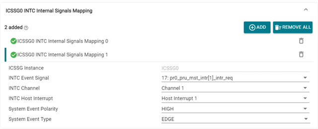

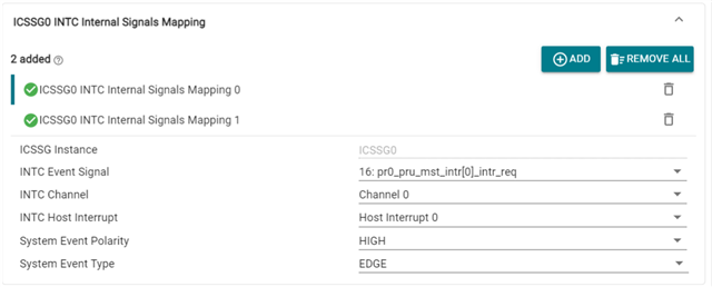

I need to synchronize activities between the R5F core and the PRU by means of interrupts.
I have configured the INTC using SysConfig as follows:
Relevant sections of the code running on R5:
gPruIcss0Handle = PRUICSS_open(CONFIG_PRU_ICSS0);
PRUICSS_registerIrqHandler(gPruIcss0Handle,
                      0,
                      16,
                      16,
                      0,
                      (void*) &finished);
PRUICSS_intcInit(gPruIcss0Handle, &icss0_intc_initdata);
status = PRUICSS_initMemory(gPruIcss0Handle, PRUICSS_DATARAM(PRUICSS_PRU0));
DebugP_assert(status != 0);
status = PRUICSS_initMemory(gPruIcss0Handle, PRUICSS_DATARAM(PRUICSS_PRU1));
status = PRUICSS_loadFirmware(gPruIcss0Handle, PRUICSS_PRU0, PRU0Firmware_0, sizeof(PRU0Firmware_0));
DebugP_assert(SystemP_SUCCESS == status);
status = PRUICSS_loadFirmware(gPruIcss0Handle, PRUICSS_PRU1, PRU1Firmware_0, sizeof(PRU1Firmware_0));
PRUICSS_sendEvent(CONFIG_PRU_ICSS0, 0); // this is repeatedly called in application code
void finished(void)
    PRUICSS_clearEvent(CONFIG_PRU_ICSS0, 1);
    DebugP_log("ISR Fired \r\n");
Relevant section of code running on PRU:
mainLoop:
    ldi r0.w0, 0x21
    mov r31, r0
l_wait_for_ARM:
    qbbs l_start, r31, 30
    jmp l_wait_for_ARM
l_start:
    qba mainLoop
I don't see "ISR Fired" appear on the console - implying that the ISR isn't firing.
Please help me resolve this issue.
Also, is there any example project showcasing the configuration of INTC?
