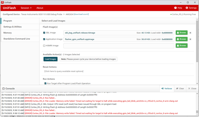

I tried to flash the code (gpio_led_blink_am263x-cc_r5fss0-0_nortos_ti-arm-clang with flash initialized) to my am2634 custom board via jtag using uniFlash software but i am getting following error("Timed out waiting target to halt").
I am uploading the sbl at 0x60000000 and application image at 0x60080000(sbl-used here is prebuilt sbl and appimage - appimage generated after building the above example file)
Following are the screenshot of the uniflash setting and error-
Note - 1. While flashing the code the state of the "cortex_R0_5" after error is Suspended
           2. I also tried reducing the input frequency for qspi flash driver even then error persist.
please guide in resolving the issue.

  • Hi Tej,
    Thank you for the query,
    Can you please help me with the below details:
    1. Which version of Uniflash tool is used? (please use the latest Uniflash version available )
    2.  Are you using a custom flash or the default flash as in Control Card.?
    If you are using the default flash then you need not tick this custom flash option.Uniflash tool will pick the default flasher binary inbuilt in Uniflash.
    If not then you will have to update the sysconfig of the below 2 projects:
    • C:\ti\mcu_plus_sdk_am263x_10_02_00_13\examples\drivers\boot\sbl_qspi\am263x-cc\r5fss0-0_nortos
    • C:\ti\mcu_plus_sdk_am263x_10_02_00_13\tools\flasher\jtag_uniflash\am263x-cc\r5fss0-0_nortos
    I see sbl_jtag_uniflash.release.tiimage is used here. This is used to flash the program via CCS.
    Please use C:\ti\mcu_plus_sdk_am263x_10_02_00_13\tools\boot\sbl_prebuilt\am263x-cc\sbl_qspi.release.tiimage file instead.
    If there is provision to change the bootmode in your custom board,  then please put the device in DEVBOOT mode.

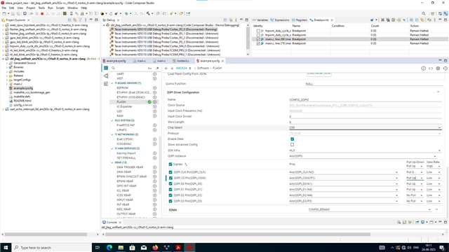

    I upgraded to SDK 11.0 and tried the sbl_jtag_uniflash example but i am getting following error-
    Following is my setting in sysconfig based on the schematic i pasted in last reply-
    Following is screenshot of schematic design for our custom card

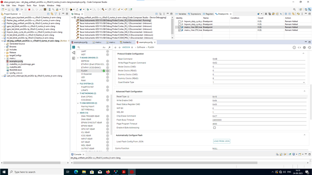

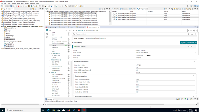

    *** DOUBT***
      2. I am using default flash(particularly s25FL256SAGNFI013) in my card.
       The above mentioned flash we are using in our design but flash considered in evalkit is "s25FL128SA". Shall i consider "s25FL256SAGNFI013"  as default flash or custom flash.
    If i have to consider (s25FL256SAGNFI013) a custom flash then what are modification i need to do in sysconfig and uniflash setting to make it work.
    Thanks and Regards.

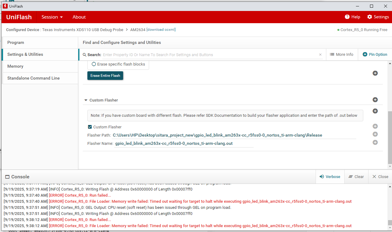

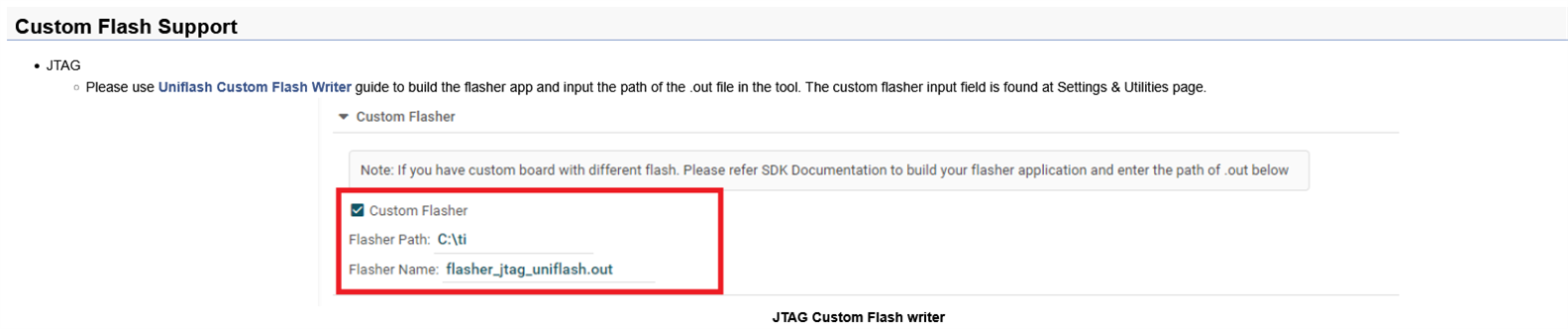

  • Hi Tej,
    Please correct me if I am wrong, I see that you are using the gpio application binary as custom flasher.
    By looking at the name of the binary and the path mentioned in custom flasher link, I see this is the gpio binary.
    You need to use the custom flasher binary at this place.
    Please see the below link to know more about custom flasher.
    https://software-dl.ti.com/mcu-plus-sdk/esd/AM263X/10_02_00_13/exports/docs/api_guide_am263x/TI_UNIFLASH_TOOL.html
    Please see the Custom Flash Support section
    Aswin

  • Hi Tej,
    Thank you for the reply. I understood that you were able to flash using the sbl_jtag_uniflash application.
    What I was pointing in the my last reply was that,
    In custom board, when you are using custom flasher,
    the flasher that needs to be used is the out file of this project, mcu_plus_sdk_am263px_11_00_00_19\tools\flasher\jtag_uniflash
    You need to align the configs of this project with that of the custom board (flash configs, pinmux) and use the out file of this project as the custom flasher.
    But in the screenshot you have attached in the question, I see that some other file is used as custom flasher. It seems like a gpio related example's out file.
    You would need to use the flasher_jtag_uniflash,out as the custom flasher, which is being currently used as the application image and gpio_led_blink_am263x-cc_r5fss0-0_nortos_ti-arm-clang should be the application image.
    Aswin

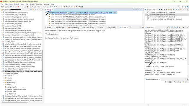

  • Hi Tej,
    I suppose after running the example, it shows that all tests have been passed. I suppose the issue is that you are not able to boot.
    Which is the boot mode being used ?
    On POR what message are you seeing in the serial terminal ?
    Can you read the flash memory and see if it is really zeros.
    Also can you tell me which flash is being used ?
    Aswin
  • Also in the bootloader, the boot image offset is asked in the sysconfig, If you check sbl_qspi, it is mentioned as 0x80000 not the real address 0x6008 0000.
    Please check the sbl_qspi_multicore_elf example in the SDK.
    Aswin
