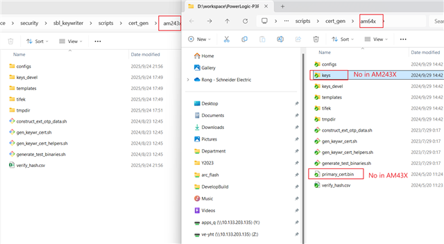

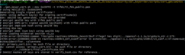

  • Hi, Prashant
      There seems to be a question about MA243X sbl_keywriter.
      I use mcu_plus_sdk_am243x_10_00_00_20, so I install otp_keywriter_am243x_v10.00.08_am243x_keywriter-windows-installer.exe, copy folder "sbl_keywriter" to "C:\ti\mcu_plus_sdk_am243x_10_00_00_20\source\security", as guide "AM64X_AM243X OTP Keywriter User Guide.pdf" in sbl_keywriter\user_guide\am64x_am243x.
      I executed this command "./gen_keywr_cert.sh --msv 0xC0FFE -t tifek/ti_fek_public.pem", there throwed error.
    Compared to AM64X, it seems to be lacking some files
  •   I executed this command "./gen_keywr_cert.sh --msv 0xC0FFE -t tifek/ti_fek_public.pem", there throwed error.
    As mentioned in the keywriter user guide, this version is compatible with OpenSSL v3.x. Mostly likely, you have OpenSSL v1.1.x. Please use the expected OpenSSL version to resolve the error.
