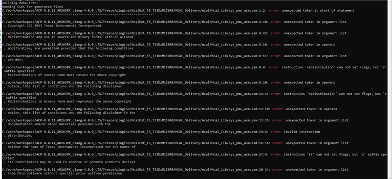

currently we are working on AM26xx MCAL 11.00.00.
Below Code Compilation error is reported while integrating Cdd_Ipc from mentioned MCAL package:
all these symbols are referenced in sys_pmu_asm.asm.
After including sys_pmu_asm.asm in build, below error message is reported:
We are using ARM-CLANG-4.0.0_LTS and assembler doesn't recognize or support ";" for comments. After replacing ";" with "@" or "//" Compilation looks ok.
Could you please provide your feedback on this?

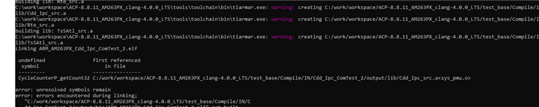

    May I know how have you added sys_pmu_asm.asm?
    The MCAL has #include "sys_pmu.h" which can be used to get the definition of this (Can be seen in ipc_notify_lld_utils.c)
    Is this how you are currently including?
    Thanks and Regards,
    Nikhil Dasan
  • Hello Nikhil,
    sorry for the late response.
    we are getting undefined symbol error for this "CycleCounterP_getCount32" symbol and as per sys_pmu.c file it is mentioned as
    "CycleCounterP_getCount32 is implemented in sys_pmu_asm.asm" and we have included this in our build environment.
