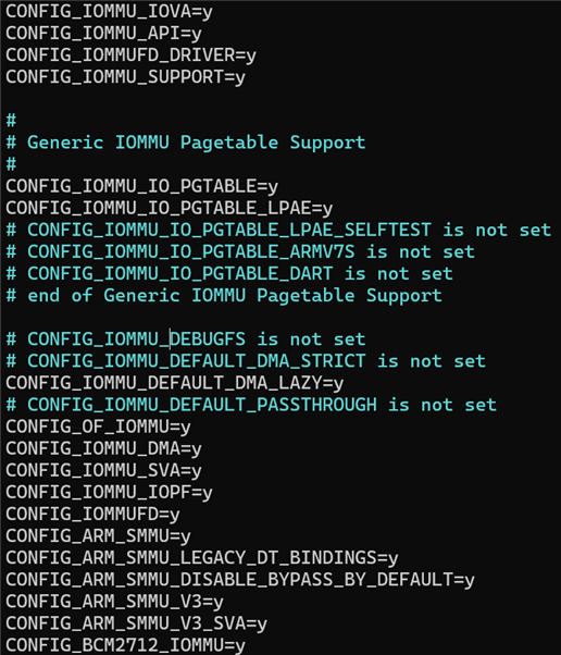

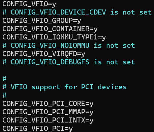

I have rebuilt the kernel with VFIO and IOMMU enabled on WSL2 and successfully booted the Raspberry Pi CM5 with kernel version 6.12.40-v8-16k+.

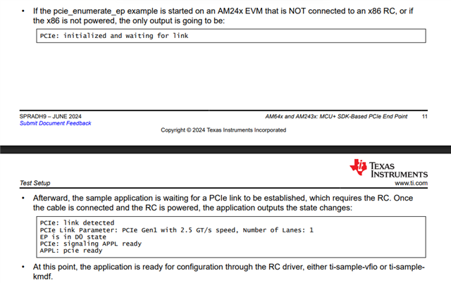

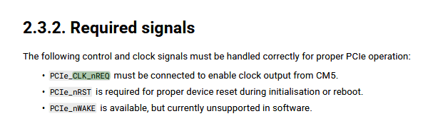

However, simply connecting the CM5 and TMDS243EVM does not result in enumeration.
(The log shows “PCIe: EP initialized and waiting for link”, but never “PCIe: link detected”.)
Currently, enumeration works only under the following sequence:
  1. Connect a NIC (which works properly as a PCIe network interface card) to the PCIe connector of the CM5 IO board via an M.2 to PCIe riser, then reboot the CM5 → enumeration succeeds.
  2. Disconnect the NIC, connect the TMDS243EVM PCIe EP, then reboot the CM5 → enumeration also succeeds.
(Only then do I see the “PCIe: link detected” message in the logs.)
So, the enumeration issue itself still needs to be resolved.
In addition, even when I run the following command on the CM5:
echo "17cd 0100" > /sys/bus/pci/drivers/vfio-pci/new_id
the following messages do not appear:
PCIe: power state entry
EP is in D3hot state
PCIe: signaling APPL halt
APPL: pcie not ready
Is this because it’s running on a Raspberry Pi, or is there an alternative approach?
