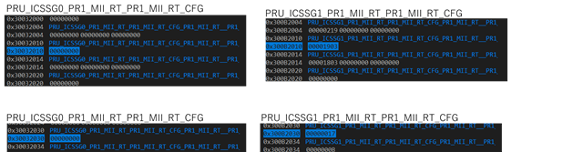

    480ns is not expected. What is the value you are seeing in the register?
    TX_IPG0 0x30032030 0x17U
    TX_IPG1 0x30032034 0x0BU  was set.

    I checked it in this way
    1. Use the debugger to confirm that 0x17 is written to TX_IPG0.
    2. Overwrite the TX_IPG0 register (0x30032030) with 0x17.
    3. Run → Check the signal and confirm that the IPG remains at 480 ns.
    4. Break and check the TX_IPG0 register → 0x17 is written.

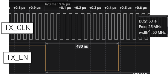

    The PHY used is a DP83822l.
    The TX_CLK is 25 MHz, and a waveform diagram is shown below.

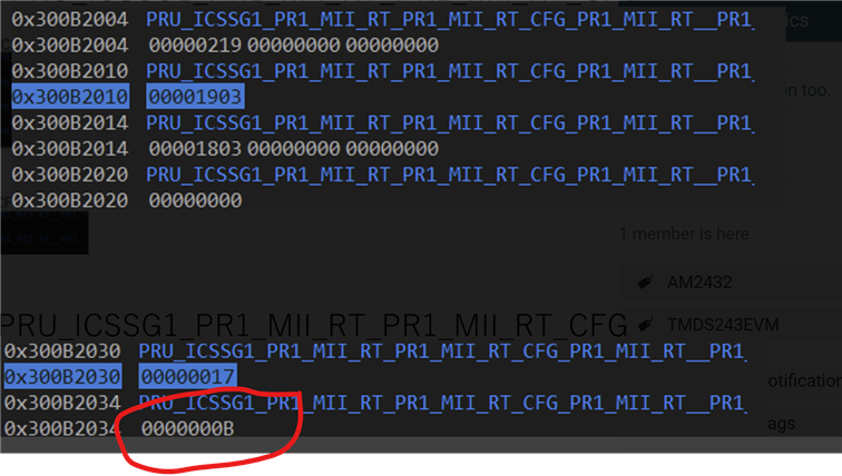

    TXCFG0 is 0x00001903 Addr:300B2010
    TXCFG1 is 0x00001803 Addr:300B2014
    For reference, the memory values ​​are pasted directly into the diagram.
    In previous questions and answers, I referred to register 0x30032030 (ICSSG0), but the correct value is register 0x300B2030 (ICSSG1).

    I still see 0x0000000B, looks like you have swapped MII pins.
    0x0000000B = 100M = 480ns

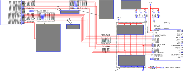

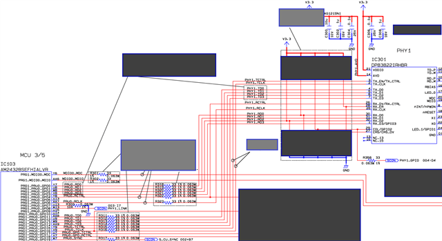

    I've attached the PHY circuit diagram (some parts have been masked).
    Although I haven't used it yet, there is another similar circuit called PHY2.
    ↓PHY2 (unused)

    I don't see any issue w.r.t schematics above.

  • While running a test for this issue, I dumped memory at the following address:
    ICSSG1: 0x030080000 to 0x0300BC0FF
    memory.dat
