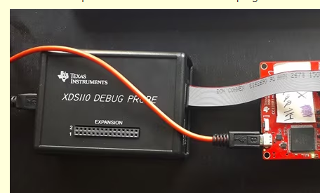

I have a LP-AM243 some how ,  It can not detect the COM port, how to use TMDSEMU110-U to program it back ? Also on the board you have very small  test point TP15,TP16,TP17,TP18 for TMS,TCK,TDO,TDI. What adapter can you connect it to.

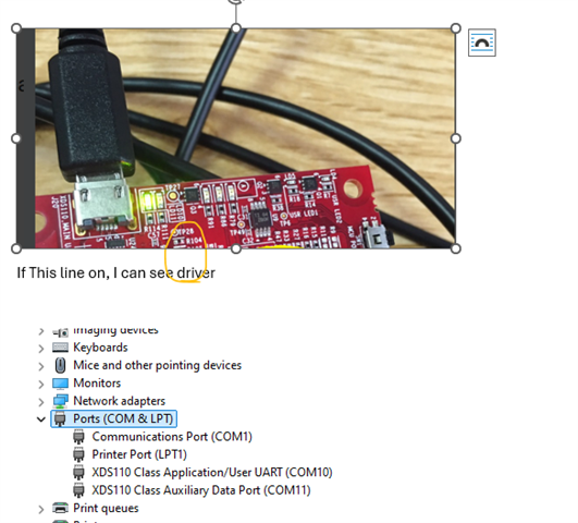

    Please follow the steps mentioned at EVM_SETUP_PAGE to setup the EVM.
    Also please install the UART to USB driver from FTDI to see the COM ports.

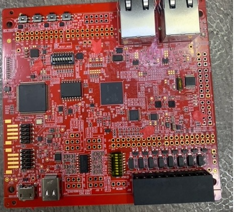

    This is new board ,that I got the Gerber file from TI and I used your gerber relayout. I need to instruction how to install firmware to new boards.
    Do I need to use the XDS110 or XDS200 Debug probe to JTAG
    to install the firmwave. ?

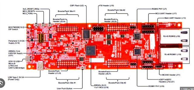

    The method to initialize the SOC will be same for TI AM243x-LP or custom AM243x-LP. On TI EVM we have inbuilt XDS110 debugger circuit which allows to debug the program by connecting to it via CCS.
    In your custom board what is the JTAG interface? The AM243x-LP supports both XDS110 and XDS200 debugger.

  • I used 100% TI LP-AM243 schematics, This have inbuilt XDS110 debugger , So I want to load firmware for XDS110 debugger to my board. Please show me instruction or .bin file for XDS110.  ****** I need to install XDS110 firmware *************.  Or if you have custom chip XDS110, Please let me know the part number for this IC.
     LP-AM243 (I USED this design )                                                             TMDS243EVM (This version have Jtag connector )
  • Please show me instruction or .bin file for XDS110.  ****** I need to install XDS110 firmware *************.
    Please follow the instructions provided at emu_xds110_manual-update
