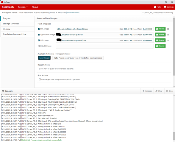

Using Uniflash 9.3.0.5401.  TMDSCNCD263P Rev A.
Generated standalone command line package using onboard XDS110 to program SBL, mcelf and mcelf_xip images.
Works fine from the Uniflash GUI.
But when running dslite-Cortex_R5_0.bat from CLI it consistently fails trying to program mcelf_xip image using address 0xE000_0000.

Here's the full log.
uniflash_dslite_xip_log.txt
The same issue is seen when using appimage and address 0xF000_0000.
Is there a special step or command to program the XIP image?  and why did the standalone command line package not generate the proper commands?
