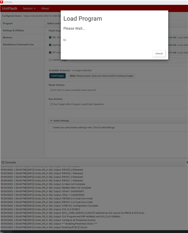

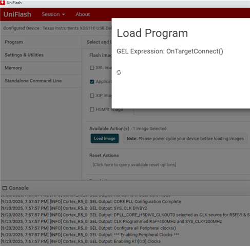

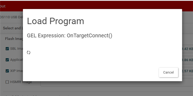

Using uniflash 9.2.0 and 9.3.0 on TMDSCNCD263P and BOOTMODE=OSPI(8s)
Uniflash tools keep hanging when it reaches:
"Enabling RTI[0:3]Clocks" and "GEL Expression: OnTargetConnect()"
I don't have the exact sequence to replicate this, but switching applications, switching between 9.2 and 9.3, computer going to sleep may have something to do with it.
Once it gets into this state, it will stay in this state unless I close the tool and run fsclean.bat.  And even this sometimes needs to be done several times.  Including disconnect the USB cable to XDS110 sometimes.
I've tried reinstalling both versions.
How can I make this experience better for the team.  Seems people are seeing this quite often and are getting very frustrated with having to restart and reselect the files.
And when we are using on a remote machine, it is not convenient to pull the debug cable.
Any help to improve this is appreciated.
    Typically this is an issue with the device being in a bad state. However, it is odd that clearing the cache resolves this. It could be the cache getting corrupted when switching between versions.
    Based on the nature of the error, it looks like it occurs when UniFlash simply connects to the target and before any flashing is attempted.
    I will try to reproduce this on my end.

  • ok, just happened again.  Power cycle board, tried programming SBL,appimage using 9.2, fails after a few blocks have been written (expected behavior from the gui.  Typically loading images again works).  Closed 9.2, opened 9.3, power cycled board, loaded the same images, and it hung here for 1 minute
    then hung here permanently.
    power cycled board and tried loading again, still stuck at same spot.

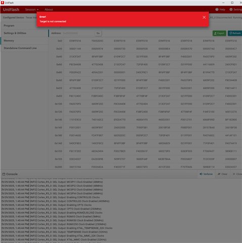

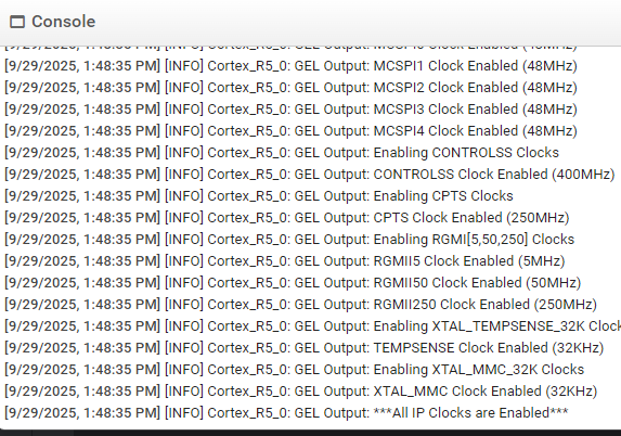

    Pressed cancel and did a memory read.
    Seems to get bass the RTI issue but still unable to do a proper read.

    [9/29/2025, 1:45:44 PM] [INFO] Cortex_R5_0: GEL Output: CPTS Clock Enabled (250MHz)
    [9/29/2025, 1:45:44 PM] [INFO] Cortex_R5_0: GEL Output: Enabling RGMI[5,50,250] Clocks
    [9/29/2025, 1:45:44 PM] [INFO] Cortex_R5_0: GEL Output: RGMII5 Clock Enabled (5MHz)
    [9/29/2025, 1:45:44 PM] [INFO] Cortex_R5_0: GEL Output: RGMII50 Clock Enabled (50MHz)
    [9/29/2025, 1:45:44 PM] [INFO] Cortex_R5_0: GEL Output: RGMII250 Clock Enabled (250MHz)
    [9/29/2025, 1:45:44 PM] [INFO] Cortex_R5_0: GEL Output: Enabling XTAL_TEMPSENSE_32K Clocks
    [9/29/2025, 1:45:44 PM] [INFO] Cortex_R5_0: GEL Output: TEMPSENSE Clock Enabled (32KHz)
    [9/29/2025, 1:45:44 PM] [INFO] Cortex_R5_0: GEL Output: Enabling XTAL_MMC_32K Clocks
    [9/29/2025, 1:45:44 PM] [INFO] Cortex_R5_0: GEL Output: XTAL_MMC Clock Enabled (32KHz)
    [9/29/2025, 1:45:44 PM] [INFO] Cortex_R5_0: GEL Output: ***All IP Clocks are Enabled***
    clicking refresh causes it be stuck again
    Closed uniflash, reconnect, power cycle, load program and still stuck at Enable RTI Clocks.

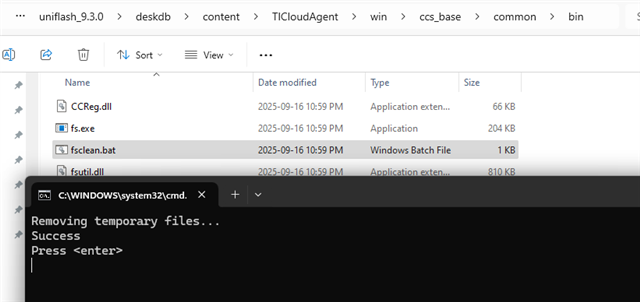

    Cancel, closed uniflash and ran fsclean.bat
    Started uniflash again, connect, no power cycle, and load program again and it worked.
