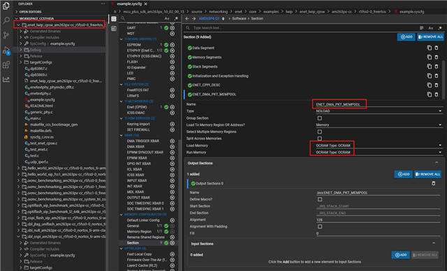

AM263P4: For ENET examples, do the buffers in .bss:ENET_DMA_PKT_MEMPOOL need to be uncached?
Part Number: AM263P4

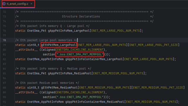

In enet examples (ie. enet_lwip_cpsw) Eth packet pool memories are assigned to ENET_DMA_PKT_MEMPOOL, which are then load and run in OCRAM.  This is cached memory.
Since these buffers are using "DMA" to be updated, should they not be mapped to a memory section that is uncached to avoid cache incoherency?  The descriptors in ENET_CPPI_DESC are set to uncached.
Just wanted to make sure this was not an omission.

    We only mark the CPPI descriptor memory location as non-cached. The ENET_DMA_PKT_MEMPOOL buffers placed in OCRAM are cached and we handle the cache coherency operations (Writeback and invalidate) in the enet driver (enet_cpdma.c) via EnetOsal_cacheInv and  EnetOsal_cacheWbInv APIs.
    As per my discussion with the networking team, having the ENET_DMA_PKT_MEMPOOL marked as non-cached affects the enet throughput. I'd recommend having the configuration as shown in the default out-of-box examples. Rather than negatively affecting performance, this approach actually improves overall system performance when properly managed:
    1. For TX (transmit) operations:
    • Before sending a packet, the driver calls EnetOsal_cacheWbInv() to write any modified data in cache back to main memory and invalidate the cache line
    • This ensures the DMA controller reads the correct, updated data from memory
    2. For RX (receive) operations:
    • Before providing a buffer to the DMA controller, the driver calls EnetOsal_cacheInv() to invalidate any cached data.
    • When the CPU later accesses the received data, it will fetch from main memory rather than using potentially stale cached data
    Using non-cached memory for buffers would avoid the need for explicit cache management but would significantly slow down CPU access to the packet data, which is typically more performance-critical than the overhead of cache management operations. The CPPI_DESC region is kept non-cached because these descriptors are frequently accessed by the DMA controller but infrequently accessed by the CPU, so the cache benefits would be minimal compared to the coherency management overhead.
