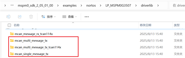

I have a SW that runs perfectly fine with CAN HS
I need to convert it to CAN FD, at least to have the compatibility with a CAN FD network
i activated the CAN FD option in Sysconfig but i have evidence that it still sends CAN HS frame
I see that there is an interrupt to handle CAN FD, unused
Is there an example that I could use, please,
