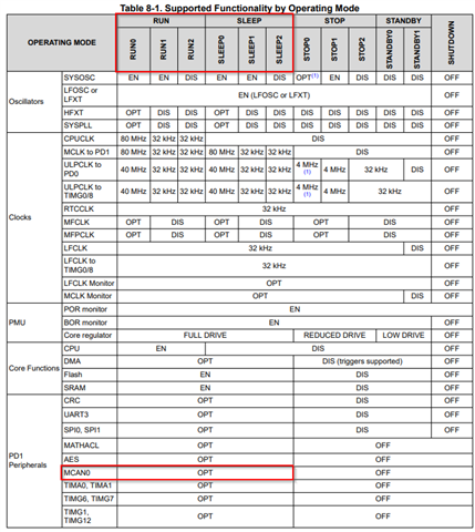

  • Thanks - idea is not to wake up module from the CAN but to wake CAN from the module. Will it work?
  • Hi T,
    What do you mean by module?
    Here is a screenshot of the device operating mode table:
    MCAN is only operational when the device is in RUNx and SLEEPx modes. The wake configuration described in previous posts is only relative to the CAN peripheral. I was able to find an Application Note that illustrates MCAN operation in other low power modes under Section 4.4.
    You can use a CAN transmission from one device to wake the CAN on devices apart of the same bus. This is done by using the previously mentioned SysConfic settings.
    You can also configure the CAN Rx pin of the connected devices to be an input with an enabled edge fail interrupt. This means when a CAN message is received it wakes the device from a low power mode such as STANDBY0, to a SLEEPx or RUNx power moder where CAN is operational. CAN must now be reconfigured on the awoken device. This process is further shown in the App Note linked above.
    I hope this was able to help, if not, would you mind clarifying your application further?
