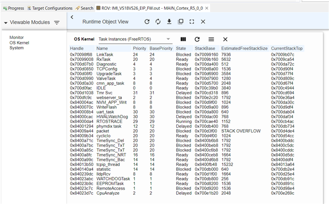

I see stack overflow in precompiled EtherNet/IP Industrial SDK, specifically in the FreeRTOS task named "packet". How to enlarge the "packet" task stack in case the EtherNet/IP is already precompiled?
Applied: INDUSTRIAL-COMMUNICATIONS-SDK-AM243X v11.x (the same issue in 11.00.00.08 as well 11.00.00.13).
Screenshot attached.

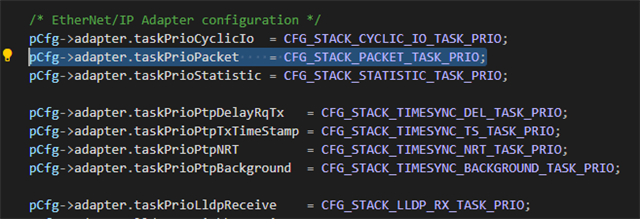

    Have you maybe changed priority in the tasks (in app.c) ?
    Pourya
  • Truth, EtherNet/IP communication priority is almost the highest from all tasks. But it is the default as your EthertNet/IP example.
    In case the UART driver is fixed to local temporary array as requested (because DRV_UART_printf(***) needs to be reentrant!), the stack overflow arise in case the EtherNet/IP communication (with PLC) is runned.
    Screenshot attached to see all priorities and the issue.

  • Hello Vit,
    Unfortunately, you'll need to wait for the next release to address this issue. If you require expedited or customized stack support, I recommend contacting your local TI Sales office to discuss potential solutions.
    In the meantime, you can resolve this problem by optimizing your application to reduce "packet" task stack memory consumption. Consider implementing these modifications:
    1. Examine any callbacks registered for your objects and eliminate large arrays or big structures within them.
    2. Review services added to your objects and similarly avoid incorporating large arrays or structures in these services.
    These optimizations are within your control, and with appropriate adjustments, you should be able to prevent stack overflow issues in the "packet" task.
