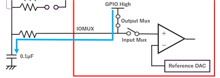

GPIO High output / Comparator input OFF
↓ Switch

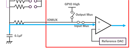

GPIO Hi-z / Comparator input ON
By performing the above operation using the same pins, the comparator can be charged and discharged.

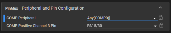

I want to do this on the same pin, but I don't know how to set it in Sysconfig.

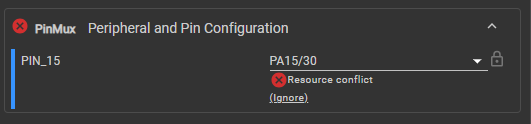

When I set COMP Positive Channel 3 Pin to PA15 as shown below, I get an error on GPIO.

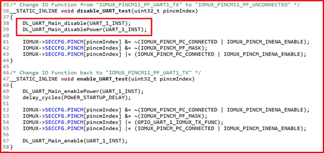

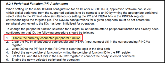

    So you want to switch the IO function between the COMP and GPIO right? you can configure the COMP function in the Sysconfig first and then refer to the below instructions in the TRM to change the function to the GPIO by code. (Please pay attention not forgetting execute the first instruction)
    Here is a UART-GPIO exchange example for your reference.
