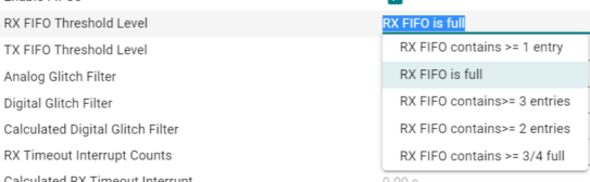

  • Hello David,
    I saw that the FIFO threshold is "full", It means when there are 4 bytes in RX FIFO, after that the RX interrupt will be triggered. Maybe you can try to set the threshod as >= 1 entry
    best Regards
    Janz Bai
  • Hello Janz,
    Thanks for your help and the suggestion. I tested it, and it doesn't solve the problem. Unfortunately, the interrupt isn't called. I have the feeling there's a general problem with interrupts in my project. I also have a timer that's supposed to call an interrupt promptly, but unfortunately, it doesn't call its interrupt either.
    i enabled the NVIC interupt request with:
    NVIC_EnableIRQ(UART_0_INST_INT_IRQN);
    and i enabled the interupt of the UART with:
    DL_UART_Main_enableInterrupt(UART_0_INST,DL_UART_MAIN_INTERRUPT_RX);
    is there maybe one step i missed for the interruptcontroller to work properly?
