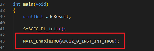

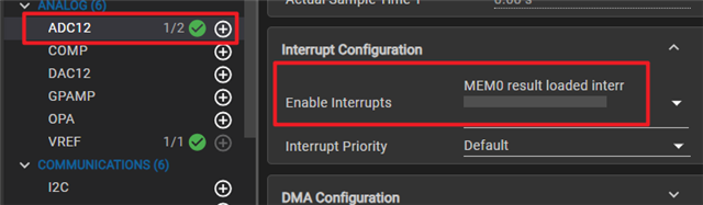

    If so, need to check following two points:
    1. Check if enable the corresponding "result loaded interrupt" in the Sysconfig.
    2. Need to enable the ADC Interrupt in the "main" function.

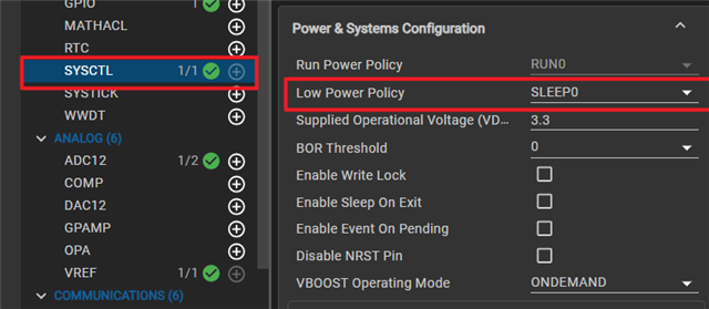

    while (false == gCheckADC) {
        __WFE();
    When execute the "__WFE()", it will enter the default low power mode which you set in the Sysconfig as shown below.
