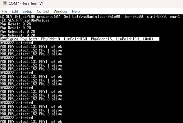

AM2432: Phy address seems not change
Part Number: AM2432
Hello Team,
My customer is testing ind_comms_sdk_am243x_11_00_00_13's ethercat_subdevice_demo\402_cia with CCS20.2.0.
example code is using address 3, 15 and customer changed it to 3 and 1.
and when it comes to log, it is the still showing 3 and 15.
What should be done to change the address properly?
