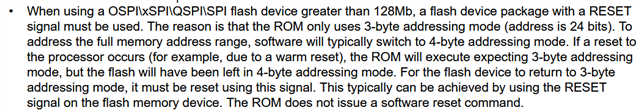

Is a reset pin necessary for the FLASHROM used in QSPI boot?
To reduce costs, we are considering using a low-cost FLASHROM without a reset pin.
I would like to know the risks of using a FLASHROM without a reset pin in this case.
