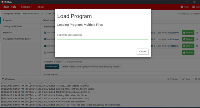

Time being im using AM263px CC dev board and micro usb cable on board debugger to flash. I tried flashing the bin file using uniflash tool by keeping boot DIP switches in xSPI boot mode but it throwed error.

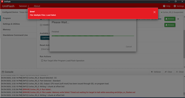

  • Time being im using AM263px CC dev board and micro usb cable on board debugger to flash. I tried flashing the bin file using uniflash tool by keeping boot DIP switches in xSPI boot mode but it throwed error.
    Can you share the snippet of the error?
  • This looks like a known issues that we have recently found with Uniflash Tool, team is working on root causing this.
    So the issue behaviour is like it will fail to flash in first iteration, but second iteration onwards it works fine.
    Do you observe something similar or in your case, it never suceeds.

    Board:- AM263px CC board
    Connection:- USB micro cable which is connected to CC board's on board debugger
    Tool:- uniflash, on uniflash GUI board is auto detected and i clicked start button
    Boot DIP switches:- selected as xSPI boot mode
    then i selected SBL image as SDK's prebuilt SBL image "OSPI_multicore_elf" SBL image
    then application image from my own project
