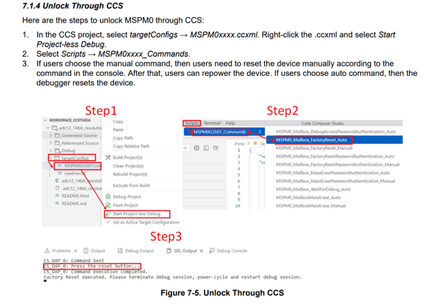

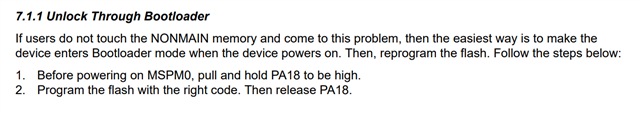

  • Hi JV,
    Sorry for the late replay due to the labor holiday so that out of office before, please let the device enter into the BSL mode firstly and then try to do the factory reset again.
    You can refer to the following step to enter the BSL mode, and then follow the previous answer above to do the factory reset.
    Peter

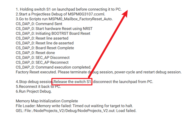

  • I have done the following steps
    The custom board is connected to lauchpad via 5 pins (NRST,SWCLK,SWDIO,GND,3v3)
    (I have verified these connections are proper because its working with another custom board, this board is also working with the same connection in old CCS
    with the error mentioned first in this thread but takes a lot of time.
    1. Holding switch S1 on launchpad before connecting it to PC.
    2.Start a Projectless Debug of MSPM0G3107.ccxml.
    3.Go to Scripts run MSPM0_Mailbox_FactoryReset_Auto.
    CS_DAP_0: Command Sent
    CS_DAP_0: Start hardware Reset using NRST
    CS_DAP_0: Initiating BOOTRST Board Reset
    CS_DAP_0: Reset line asserted
    CS_DAP_0: Reset line de-asserted
    CS_DAP_0: Board Reset Complete
    CS_DAP_0: Reset done
    CS_DAP_0: SEC_AP Disconnect
    CS_DAP_0: SEC_AP Reconnect
    CS_DAP_0: Command execution completed.
    Factory Reset executed. Please terminate debug session, power-cycle and restart debug session.
    4.Stop debug session,Release the switch S1, disconnect the launchpad from PC.
    5.Reconnect it back to PC.
    6.Run Project Debug.
    Memory Map Initialization Complete
    File Loader: Memory write failed: Timed out waiting for target to halt.
    GEL: File: /NodeProjects_V2/Debug/NodeProjects_V2.out: Load failed.

  • Hi JV,
    Could you please try again to release the S1 button after connecting to the PC for >1 second in step1 to see whether the issue still exist? no need to wait in step 4 to release the button.

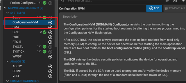

    In addition, have you modified the Nonmain region in the Sysconfig?
    Peter
  • I have tried that several times.I am holding the switch s1 plugging the lauchpad holding for 3-4sec leave.Then tried to flash same error comes(Timed out waiting for target to halt).
    I am not using sysconfig. And I have not modified the Nonmain region.

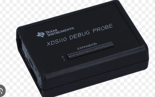

  • Are you using the debugger as shown below to flash the firmware?
  • no i am using Direct connection from lauchpad. Launchpad has inbuilt XDS110 right?I have mentioned all these things above please refer to this thread.
  • Yes, even after Factory reset the error persists.I dont care about this direct download. I want this functionality where i can debug any code into the custom board, that is not working.
