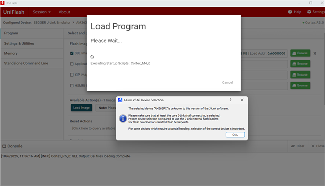

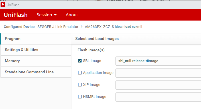

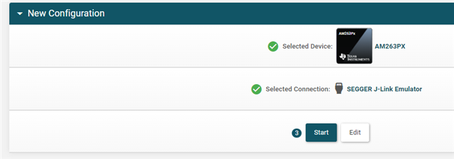

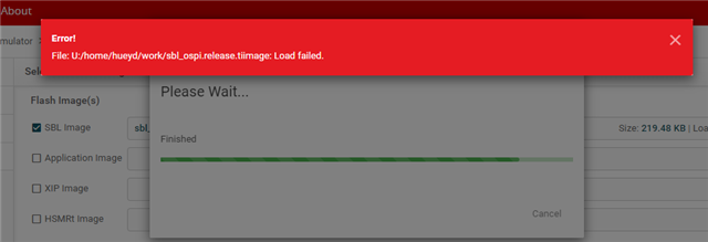

Trying to use Uniflash 9.3 with Segger J-Link Basic probe to program TMDSCNCD263P Rev A board but fails trying to program prebuild SBL image.

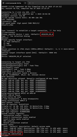

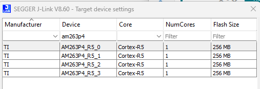

Installed SEGGER v8.72a.   The connection seems to be correct (see J-LinkCommander log below).

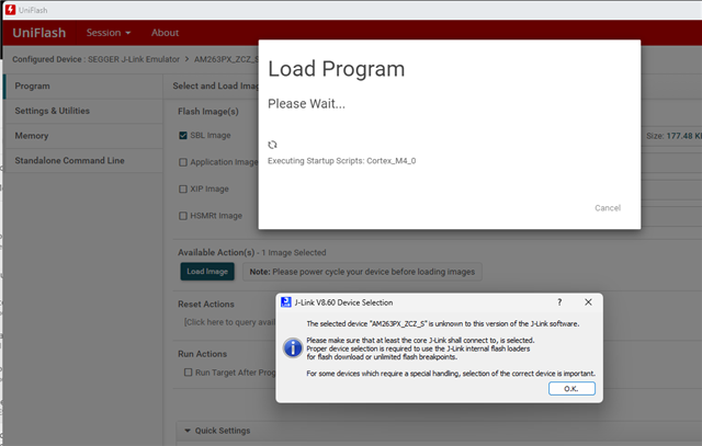

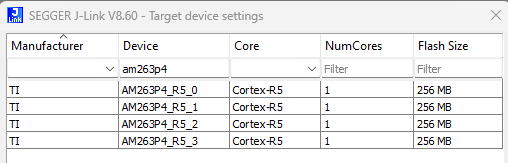

When loading program, it complains "AM263PX" (or other variants) is unknown to this version of J-Link Software.
After selecting AM263P4_R5_0, the load proceeded then failed trying to program.

[9/29/2025, 2:26:59 PM] [INFO] Cortex_R5_0: GEL Output: CPU reset (soft reset) has been issued through GEL on program load.
[9/29/2025, 2:27:02 PM] [ERROR] Cortex_R5_0: Trouble Writing Memory Block at 0x60027fb0 on Page 0 of Length 0x463c: Flash download failed! ...
[9/29/2025, 2:27:02 PM] [ERROR] Cortex_R5_0: File Loader: Verification failed: Target failed to write 0x60027FB0
Jlink is connected properly through TMDSHECDOCK and LED on probe is solid green.   Using J-Link Commander, this shows probe is connected properly.
Can an expert help guide me through this process?  I'm not sure where I went wrong here.
