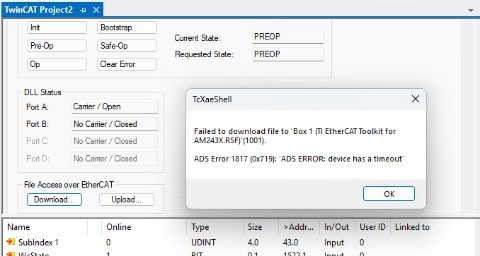

    Thank you for your proposal, and sorry for our delayed response. The customer tried again without any modifications to ethercat_subdevice_simple_demo_am243x-lp_r5fss0-0_freertos_ti-arm-clang of ind_comms_sdk_am243x_2025_00_00_05. Then, an error occurs. Please see below for details.
    - ind_comms_sdk_am243x_2025_00_00_05
    - build ethercat_subdevice_simple_demo_am243x-lp_r5fss0-0_freertos_ti-arm-clang without any modification.
    - download .out and run (debug mode) with no breakpoints.
    - follow steps described in:
    - file:///C:/ti/ind_comms_sdk_am243x_2025_00_00_05/docs/am243x/ethercat_subdevice/_fo_e_page.html
    - section : File Download
    They got an error on TwinCAT with 20byte text file:
    Do you have any idea to solve this error ?
    Thanks and regards,
    Hideaki
  • Hi Hideaki,
    Yes. I was able to reproduce the timeout issue when downloading a smaller file (<256bytes) via FoE and I have shared the patch to fix this issue over a mail.
    Kind Regards,
