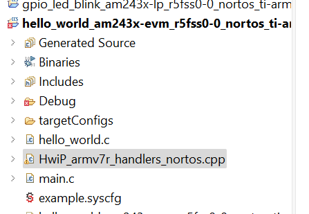

  • Sorry for the late reply.
    So I tried it by just adding a .cpp-file with the redefinitions to the hello_worls-example and ti gives me exactly those issues:
    File is added here:
    content of the file:

    Felix
  • Hi Felix,
    Apologies for the delay here. I am able to replicate the issue with the method suggested above.
    I checked the project and SDK, all the compiler options and flags are identical for both project and SDK but the issue still persist.
    I am still debugging, the current workaround is already mentioned  here.
    Tushar
  • Hi Felix,
    I want to know if I am doing something wrong, since the compilation of the sdk does not produce those warnings, but the exact same TI-code compiled in our code-base does, even if it does not use our code-base at all.
    The warnings were not generated while compiling the SDK files, because -Wno-extra flag is used in the SDK's makefile. If you remove that flag you will see build issues(because of -Werror flag) with SDK also.
    For more details, please refer
    ARM-CGT-CLANG: warning: call to function could clobber interruptee's VFP registers; consider using the `interrupt_save_fp` attribute to prevent this behavior [-Wextra]
    Tushar
