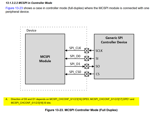

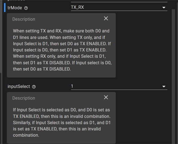

Jayakeerthana,
You can also configure this at the sysconfig/driver level by adjusting these fields in the mcspi section of the software tab on sysconfig:
Brennan
