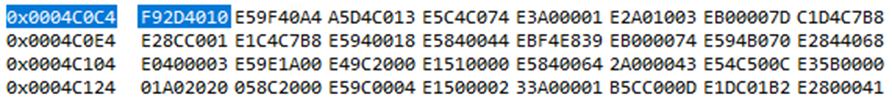

Then the first instruction of function Scheduler_L4() looks as follows:
So, the instruction changed from 0xE92D4010 to 0xF92D4010.
Further information: Cache is enabled and the complete code which is copied to RAM is called within the Software Interrupt ISR.
Can you please help me, why there is this obvious dependency with the size of code copied to RAM to the changed instruction in one of the functions…
All the settings (HALCOGEN, linker file) are unchanged, only the size of code changed.

    Is it possible to verify the same instruction in flash? I mean i want to know whether it is corrupted during copying into RAM or it is just corrupted in flash itself?
    Here is the function in RAM with the first wrong instruction 0xF92D4010
    And here is the function in FLASH:
    The function is completely the same. So, the error did not happen during runtime but during compilation/linking?
    And also disable cache and see the behavior for 0x57ac? Any change in the behavior?
    When disabling the cache, this one function seems to be correct:
    The first instruction is not undefined anymore, but somehow it changed from 0xE92D4010 to 0xE82D4010.
    But I found another function which was copied from FLASH to RAM where an instruction is undefined:
    This instruction is also wrong in FLASH.
    I think disabling the cache brings no changes to this problem.
    The main question is, why is it also wrong in FLASH?
    Thank you again for your help
    Christian
