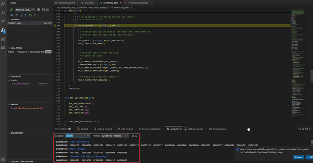

My MSPM0L1306 application is greater than 4K and is located at 0x0000. If I try to load this image with the secondary BSL it overwrites the FLASH area where the secondary BSL resides. I tried relocating the secondary BSL to 0x4000 as described in SLAAE88D MSPM0 Bootloader Implementation Section 5.3.1 including the changing Sysconfig setting for the Alternate BSL address to 0x4041, but does not work. Is there anything else I need to do??
Frank
  • Hi Frank,
    Could you share what your linker (cmd) file looks like?
    I would suggest referencing the secondary_bsl_uart example in the SDK as well (this is for an MSPM0L1306):

    If you are using SysConfig, ensure you have disabled the generation of the linker file. Otherwise, each time you build your project, it will rewrite the file.
    Owen
  • Hi Owen,
    Right. Link file generation is disabled by default in Syscongi with that example project. Below is my modification to mspm0l1306.cmd, which I copied from MSPM0 Bootloader Implementation Section 5.3.1 .

  • Hi Frank,
    Your linker file looks good. When you say it doesn't work, you mean that the secondary BSL still starts at 0x1080?
    Have you tried rebuilding the entire project? Project > Rebuild Project?
    Is there anyway you can share your entire project?
    Owen
  • Hi Frank,
    I would also like to add that it is necessary to perform a POR upon changing NONMAIN. Any changes to NONMAIN will not take into affect until this is done.
    I was just able to adapt the SDK example to move my BSL to start at 0x4000.
    Owen
  • Hi Owen,
    Yes, I always do a Rebuild Project. When I try to load a image with the secondary BSL > 1K I get the following error message from Uniflash (works when < 1K). I have attached a zip of my secondary BSL project and gpio project. For the gpio project I added some code to make the image size larger than 1K (const uint8_t dummy_data[4024] = {0};) in gpio_toggle_output.c. I am sure I did something wrong but can't figure it out.
    Frank

    secondary_bsl_uart_LP_MSPM0L1306_nortos_ticlang.zip5756.gpio_toggle_output_LP_MSPM0L1306_nortos_ticlang.zip
  • Hi Frank,
    Thanks for sharing the projects with me.
    The reason why the process currently fails is because SWP was configured in SysConfig. The Lower Sectors was set to 0xFFFFF00F. This protected the region of flash that contained the secondary BSL when it was located at 0x1000. Since we moved it, we need to move the SWP accordingly. I believe it should now be 0xFF00FFFF. This protects sectors 16-23.
    Now I encounter an issue regarding 8-bit alignment but I don't think it has to do with the application Hex file. I think it may have to do with the BSL, but I'll have to look into this and get back to you Monday.
    Owen

  • Hi Owen,
    Yes, I was able to replicate after changing SWP to 0xFF00FFFF.

  • Hi Owen,
    I ported the bsl_host_mcu_to_mscpm0l11_xx_l13xxI_target_uart_LPxxx example to Windows and found it works loads my image fine with the SWP set to 0xFF00FFFF!! Not sure if this points to a problem with Uniflash
    Frank
  • Hi Frank,
    The reason SWP is implemented is to prevent the BSL from being written over. Unless the program you flashed is large enough to be written over the BSL or attempt to be written to SWP memory, then it should not cause a problem. I am currently looking through the secondary BSL code to see if there's anything else that needs to be changed.
    Owen
