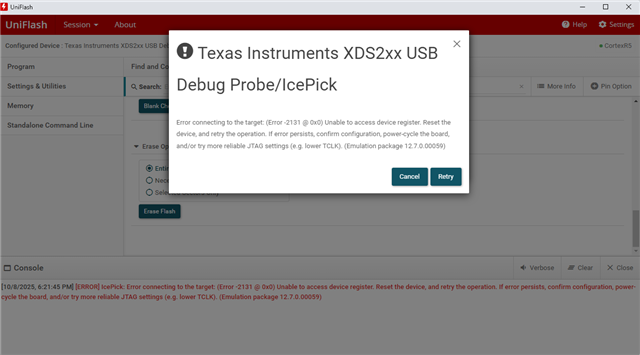

We are using TMS570LC4357 in our custom Boards, and we are flashing through Uniflash with XDS200 USB debug probe, In some of the instances (boards), we are getting the following error in CCS test connection window

and in Uniflash the following error
Once we get this error we are not able to recover this TMS570 at all, it does not allow us to erase, debug or load at all.
Can anyone provide may be the cause and solution to recover?

  • Hi Praneeth,
    Apologies for the delayed response!
    The error you're experiencing (SC_ERR_PATH_BROKEN with Error -233) indicates that the JTAG scan path is broken and cannot properly communicate with the device. Based on the search results, there are several potential causes and solutions:
    1. Hardware-Related Solutions:
    • Check the JTAG connections, particularly focusing on:
      • TDO (Test Data Out)
      • TMS (Test Mode Select)
      • TCK (Test Clock)
      • TRST (Test Reset)
    • Verify that TRST_N pin is properly connected and pulled up
    • Ensure proper voltage levels on all power rails:
      • Check if all required voltage rails (3.3V, 1.2V) are present and stable
      • Verify there are no voltage irregularities during operation
    1. Recovery Procedure: Try this specific sequence to recover the device:
    2. Open the target configuration window
    3. Launch the selected configuration
    4. Switch to debug window
    5. Press and hold the reset (nRST) button on your PCB board
    6. Click "Connect Target" immediately after releasing the nRST button
    7. You may need to try this sequence multiple times
    8. Additional Troubleshooting Steps:
    • Try lowering the JTAG clock frequency in the connection settings
    • Power cycle the board completely between attempts
    • If possible, check the JTAG signals with an oscilloscope to verify signal integrity
    • Ensure there are no sources of electrical noise that could interfere with JTAG communication
    1. Prevention for Future:
    • Review the PCB layout for potential signal integrity issues
    • Ensure JTAG traces don't cross power or ground plane splits
    • Consider adding additional filtering on JTAG lines if noise is an issue
    Thanks & regards,
    Jagadish.
