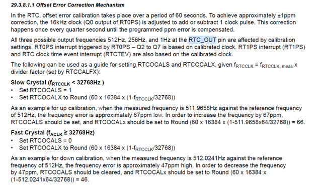

I am using the MSPM0G3519SPNR. We are attempting to utilize the RTC on the MCU, but are having trouble getting it up and running. Is the RTC_OUT GPIO functionality REQUIRED for using the RTC? I thought it was mainly for calibration.
Currently, I am using the three pins RTC_OUT is available on as standard GPIO, do I need to leave one open and assigned to RTC_OUT to actually use RTC functionality?
With respect to calibration, what would the RTC_OUT be typically connected to? Is it mainly for EOL calibration, or does RTC_OUT need to be routed to an additional IO on the MCU as well?
