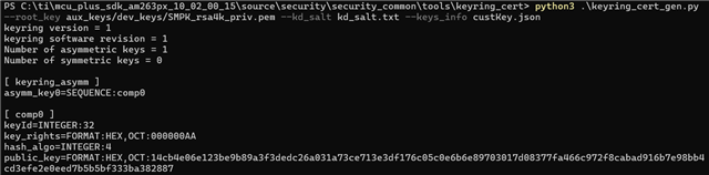

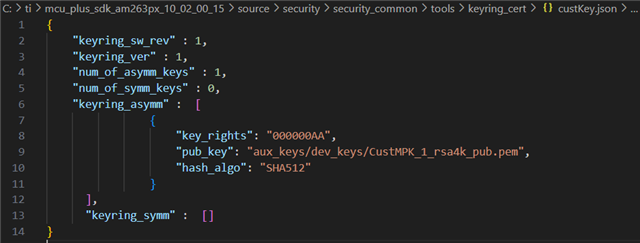

  1. Modified keys.json file like so (custKey.json):
  2. Executed the following script:
    1. python3 .\keyring_cert_gen.py --root_key aux_keys/dev_keys/SMPK_rsa4k_priv.pem --kd_salt kd_salt.txt --keys_info custKey.json
    2. The generated result is a header file named "KeyringCert.h".

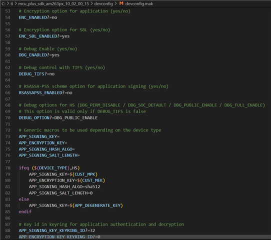

3. Modify MCU_SDK's devconfig.mak:
  • APP_SIGNING_KEY_KEYRING_ID?=32
  • APP_ENCRYPTION_KEY_KEYRING_ID?=0
