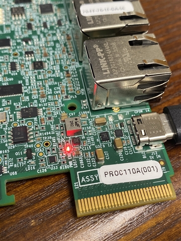

I am writing to request warranty service for a TMDSCNCD263 (AM263x Control Card) that recently failed during standard laboratory testing.
During PWM signal testing on the AM263x Control Card mounted on the TMDSHSECDOCK LP baseboard, the board experienced a sudden and complete power failure. All operational LEDs turned off instantly, and the red LD16 (Safety Error) indicator illuminated continuously, signaling a critical power fault. Despite multiple recovery attempts — including power cycling, resets, alternate power sources, and hardware inspections — the board remains non-functional.
The failure is attributed to a power delivery subsystem fault, likely involving the TPS2121RUXT power mux or associated voltage regulators. The issue was preceded by a pre-existing USB-C power input malfunction, which forced exclusive reliance on the docking station for power. No visible damage is present, but internal short or regulator failure is suspected.

    What is the laptop or computer that is being interfaced with? The AM263 EVM requires a USB port that supports PD in order to provide enough current to power the board. LD16 indicates insufficient power going to the device (see the note in page 4 of the user guide)

    Power Connection Attempts:
    1. USB-C Power Delivery (5V/3A) via J12:
      • Connected using USB-C port with PD capability providing 5V/3A to connector J12
      • Result: ERR LED illuminates, LD16 does NOT turn on
    2. Power via LP-AM263:
      • Attempted to power the board through the LP-AM263 launchpad
      • Result: Same issue - ERR LED on, LD16 off
    3. Jumper connection through LP-AM263:
      • Tried using jumper connections through the LP-AM263 to provide power and enable the board
      • Result: ERR LED still illuminates, LD16 remains off
    4. Laptop via J2 connector:
      • Connected laptop directly through J2 on the board
      • Result: Only LD7 (green) turns on
    Current Status:
    • LD16: OFF
    • ERR LED: ON (when using J12 or LP-AM263)
    • LD7: ON (green)
    • Board does not boot/enumerate properly
    I have attached a photo showing the current LED status with the ERR LED illuminated for your reference.
    My Setup:
    • Laptop: Intel Core i5-1035G1
    • Power source: USB-C PD at 5V/3A
    • Board: AM263 EVM
    • Connections tested: J12 (USB-C), J2 (direct power), via LP-AM263, and jumpered through LP-AM263
    Note: I already tried with USB3 port, still same results.

    If this is the laptop: https://www.dell.com/en-us/shop/dell-laptops/inspiron-15-laptop/spd/inspiron-15-3520-laptop It does not contain any PD USB-C ports so would not be able to power the device sufficiently
    For the workstation, according to this link: https://www.dell.com/support/manuals/en-us/precision-3660-workstation/prec_3660t_ss/front?guid=guid-8eb71770-2108-414b-8b3a-a17dba540d1a&lang=en-us you should optimally leverage port 8 with PowerShare

  • HI Renan,
    We've reviewed the issue. If following the provided guidance of leveraging the PowerStation (and NOT using laptop because the laptop ports do not provide enough power to start the device), and using the correctly identified port which supports the power share, the issue could be related to the assembly of the board by the manufacturer. Please go forward with process
    Regard
    Peter
  • Hello Peter,
    This is noted, we will go forward for the RMA replacement.
