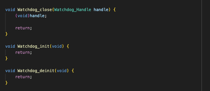

When handling a fault (e.g. handling divide by 0 trap from within undefine_instruction_handler), we want to disable the watchdog for a specific core, write some persistent information, and reboot (either by warm reset or by re-enabling the watchdog and not petting)
However, this was not working, so we investigated the SDK source. Appears that the APIs for Watchdog_close, Watchdog_deinit literally do nothing. See image 1 below.image.png
Similarly, tried refactoring to this (implementing Watchdog_close in terms of Watchdog_open but with different parameters), but that also does not seem to stop the generation of warmresets.

3 Question:
  1. What are we doing wrong? What is the proper way to temporarily disable the WWDT? Clearly it is not the HAL/SDK since the APIs do nothing
  2. Why does the example code above not work?
