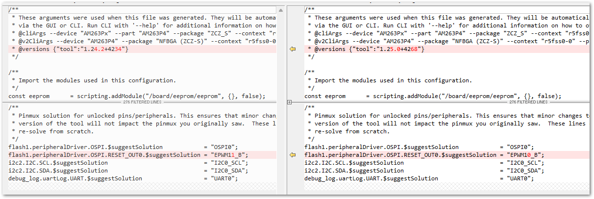

AM263P4-Q1: SysCfg unexpectedly changes OSPI Reset Pin
Part Number: AM263P4-Q1
Further to
MCUSDK-13182 : 'SysCfg unexpectedly changes OSPI Pin'
This appears to be only partially fixed. If I...
  • Import example:
C:\ti\mcu_plus_sdk_am263px_11_00_00_19\examples\drivers\boot\sbl_ospi_multicore_elf\am263px-cc\
  • Build the code (Left Hand)
  • Open the .syscfg file, change nothing except force saving.
  • Build the code again (Right Hand)
Then the reset pin has changed from EPWM11_B to EPWM_10B:
Is there a legitimate reason for this please?
