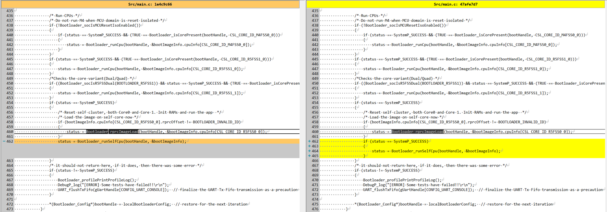

AM2434: AM2434: MCU-PLUS-SDK-AM243X v11.xx.xx.xx, bug in source/drivers/bootloader/bootloader.c module
Part Number: AM2434
Please note a bug in the "Bootloader_rprcImageLoad()" function, which occurs at least in the current version of "MCU+ SDK for AM243x – RTOS, No-RTOS." I found it while verifying your example for the SBL OSPI bootloader by deliberately loading a memory-inappropriate (at address 0x7004_0000) but signed application FW. In addition, you should also fix the "main.c" example itself (<mcu_plus_sdk_am243x_11_***>\examples\drivers\boot\sbl_ospi\{am243x-evm, am243x-lp}\r5fss0-0_nortos\main.c). See screenshots.
Thank you in advance for passing the bug on to your development team, and I look forward to the release of the fix.
