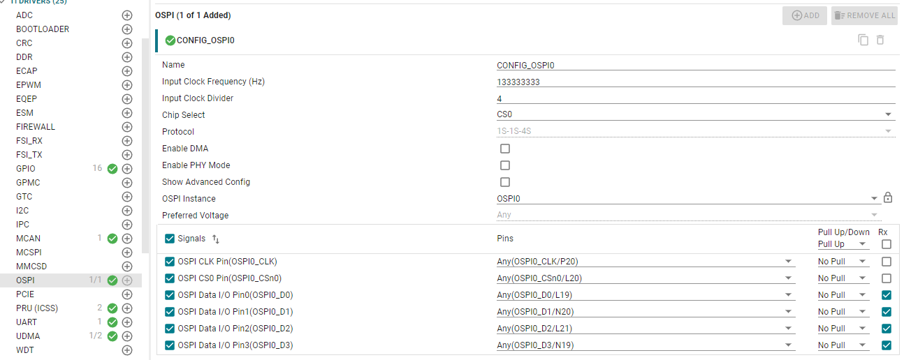

The SDK I was previously using was Industrial SDK version 9.0.0.03, and some of the sysconfig contents are as follows.
OSPI
The SDK I'm trying to change to is Industrial SDK 11.0.0.08, and the sysconfig contents are as follows.
OSPI

    The flash is using W25Q128, defined in sysconfig below.
    As mentioned before, flash reads and writes can be accessed using the provided API.
    As far as I know, OSIP recognizes the 0x60000000 area as a flash access address.

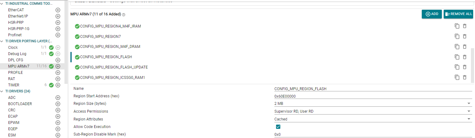

    I have checked the SysConfig screenshots which you attached.
    If you can revisit those in your application and compare the MPU ARMv7 configurations. If they are exactly same, then we can move forward.

    The MPU ARMv7 settings in sysconfig used in Industrial SDK 9.0.0.03 and in sysconfig used in Industrial SDK 11.0.0.08 are identical.
    (Photo of the sysconfig settings attached at first)
    Is there another section in sysconfig that configures these settings?
    Since the SDK versions are different, the sysconfig versions are also different.
