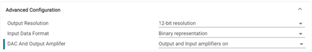

Detailed DAC sysconfig illustrated below:

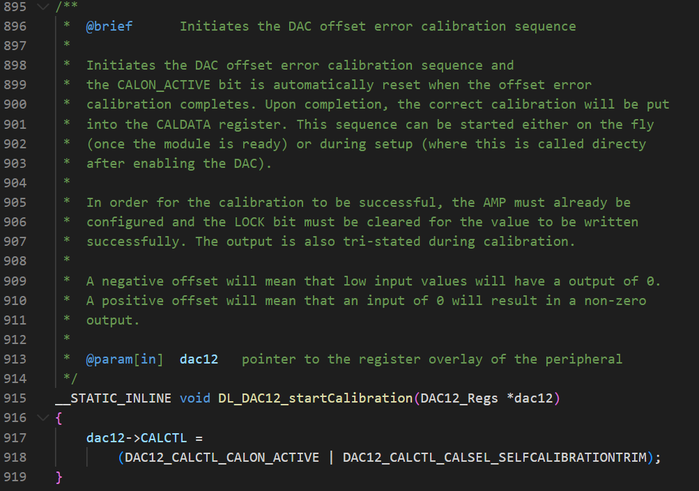

Below is a code snippet for calibration - I am using MSPM0 SDK 2.7.0.05.

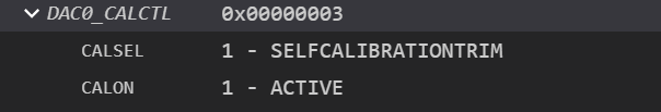

The program run into an infinite loop at the DL_DAC12_performSelfCalibrationBlocking() line, due to DAC0_CTL0.CALON bit not automatically reset. Also, the CALDATA register is not being updated. In the meantime, the DAC output pin voltage fluctuates and then converges at ~2 mV.
Further, referring to the DL_DAC12_startCalibration() function (referenced by DL_DAC12_performSelfCalibrationBlocking), in the description there is mentioning of the AMP and LOCK bits - I cannot find any reference to the latter in the DAC section of the TRM.

Could you please clarify how to correctly configure DAC output AMP settings to allow successful offset calibration? And, if relevant, how to configure the LOCK bit as described in the source code?

  • Hi Xuexi,
    I run the exactly the exmaple you shared here, it looks alright from my side.
    Try below setting for DAC0:
    The DAC AMP should be enabled before DAC calibration.
    B.R.
    Sal

    Thank you for your reply.
    I tried the calibration function with the DAC output amplifier on, it does not run into an infinite loop.

    Also, the CALDATA register is not updated after calling the DL_DAC12_performSelfCalibrationBlocking() function. Is this behaviour expected?
