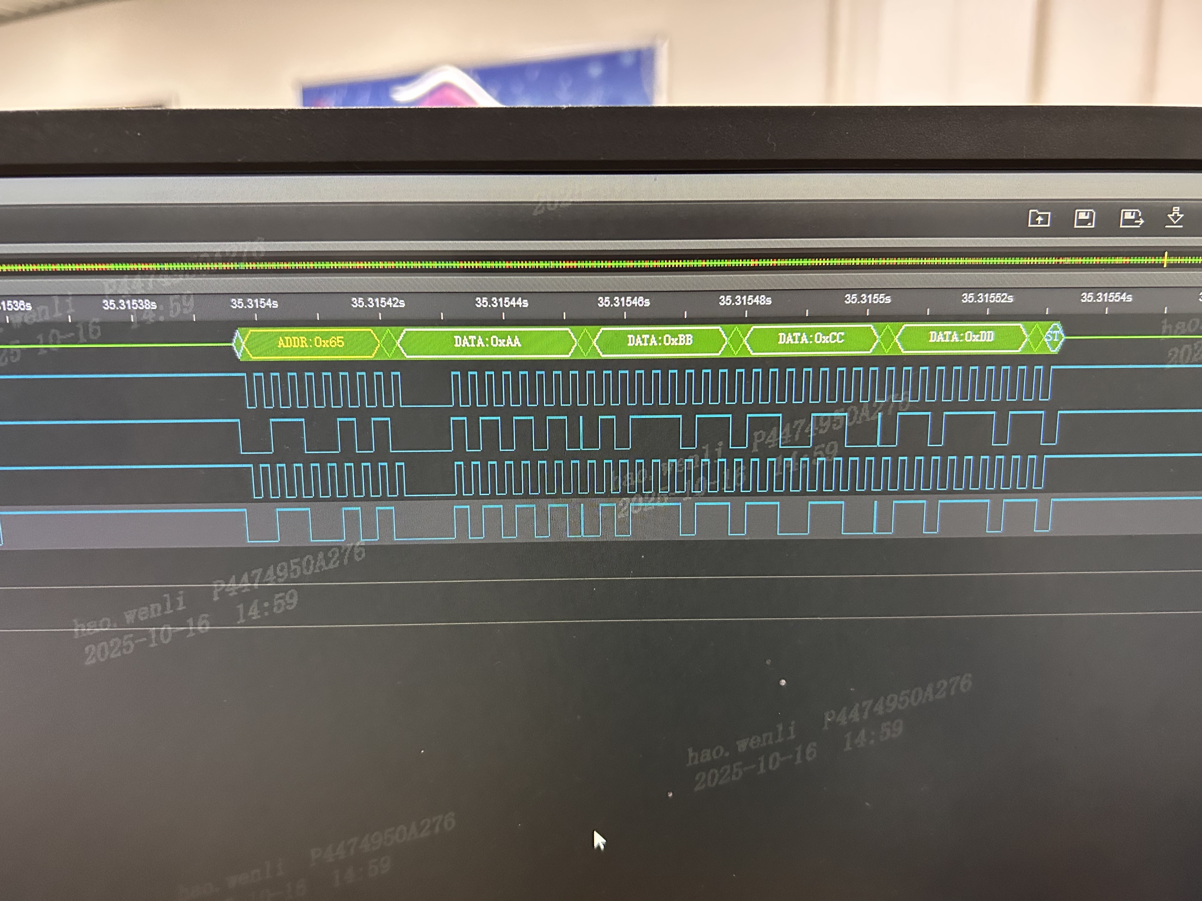

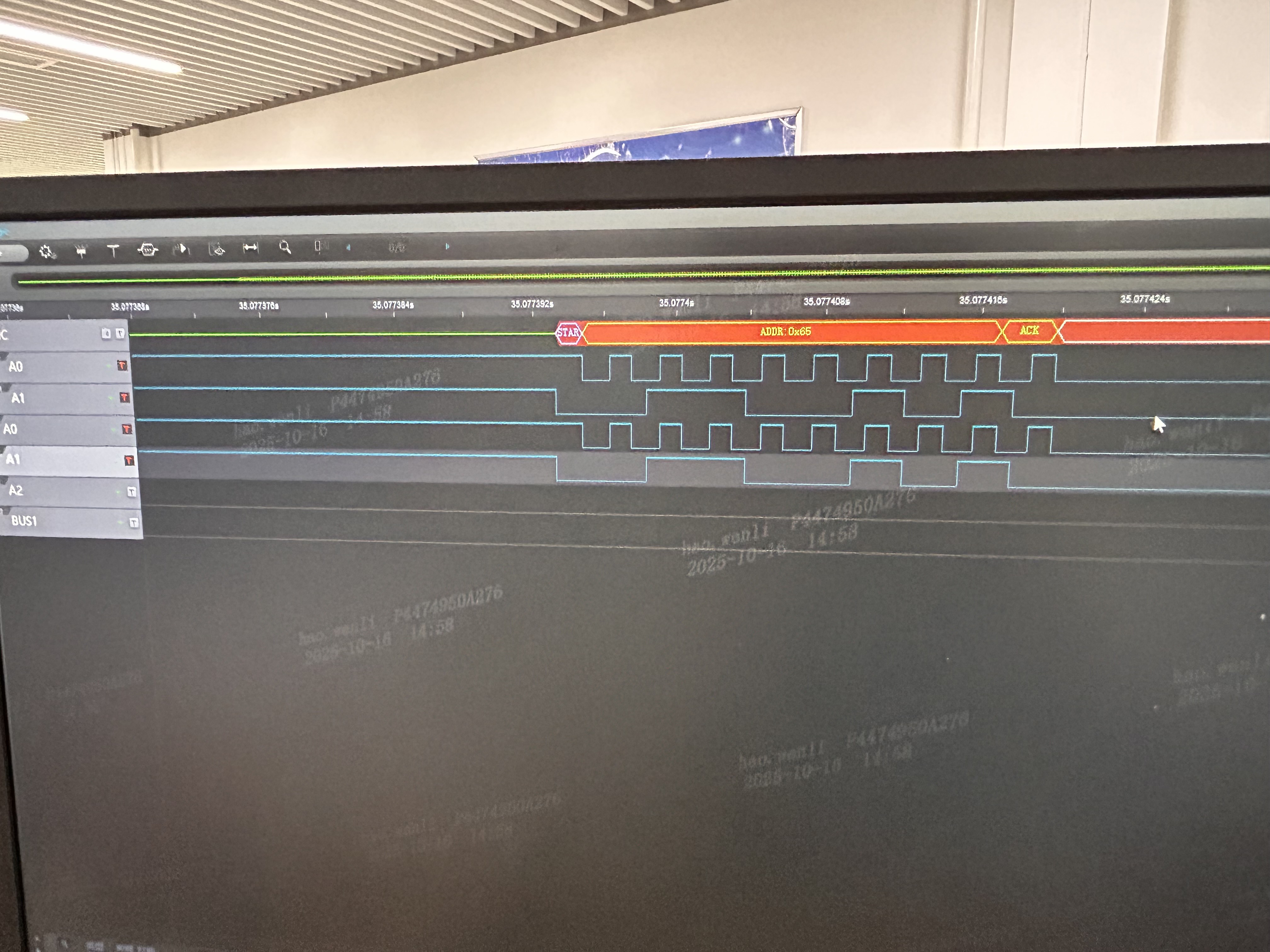

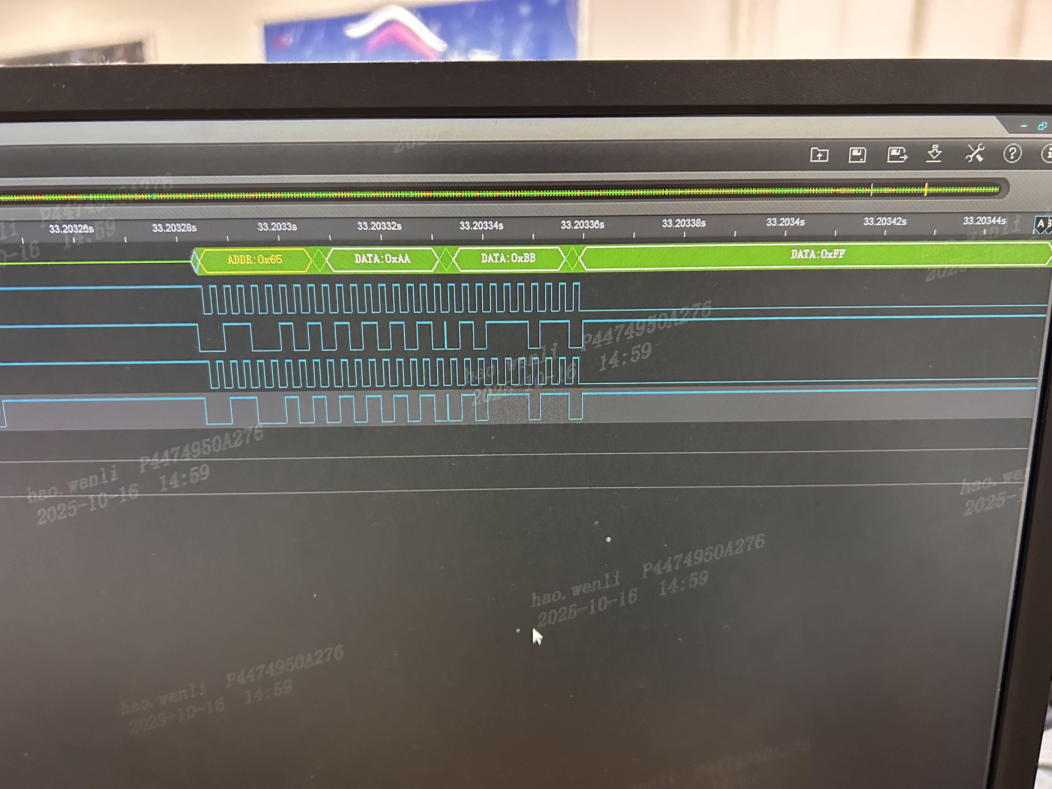

In AM2612, is there error register that can indicate I2C error? Customer is using AM2612 as I2C peripehral device using interrupt mode. She found that it can't enter interrupt occasionally, 2% possibility. It will occurs AAS interrupt or XRDY interrupt.
When it can't enter interrupt, customer found that I2C clock is driven low. Sometimes Data line will also be driven low. But at that time AM2612 still can run. If customer cut the clock line hardware between AM2612 and I2C controller device, she found that I2C controller can recover.Customer is now using SDK.
normal waveform:
issued waveform:
