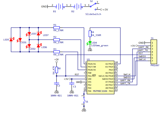

Can GPIO pins on the MSPM0C1104 be switched dynamically between input (true high-Z) and output (push-pull) without reconfiguring the IOMUX? If so, which driverlib function guarantees that the pin is fully high-impedance (no keeper, no pull, no leakage)?

    No, you will need to switch the IOMUX every time you want to switch from one state to the other. Please refer to the IOMUX diagram for reference (found in the IOMUX chapter in the TRM)

  • I try that with this test code but PA27 switch not to input :

  • Diego,
    Thanks for the info, if I look to figure 9-1  I can leave the pin to output and need to
    activate the shutdown ti switch the pin to Hi Z.
    I have to look for the shutdown command.
    best regards,
    rob Keij
  • Hi Rob,
    You are correct. However, the MSPM0C1103/4 devices don't support wake from SHUTDOWN mode. I would recommend any other mode like STANDBY0/1.
    Diego Abad
  • Hi Diego,
    Ok I try and you right for every function change of the pin and change via IOMUX  needs a complete restart.
    So the simple design with the charlieplex led is unusable. I was hoping to use the MSPM0C1104.
    I stil not understand that there is no possibility to switch a pin from output to input or floating.
    I was sure this should be possible and produce 100 pcba's :(
    I mark you first answer as "This resolved my issue"    (This answered my issue)
    best regards,
    Rob keij
  • Hi Rob,
    Let me see if I can get a deeper explanation on the topic.
    Diego Abad
  • Hi Rob,
    Actually, after talking with my team, I confirmed that as long as the functionality remains within GPIO functions (low, high, high-impedance,) the IOMUX should remain the same. However, if you want to switch from having no internal pull-ups/pull-downs to having them, that's when the IOMUX changes.
    Diego Abad
  • #include "ti_msp_dl_config.h"
