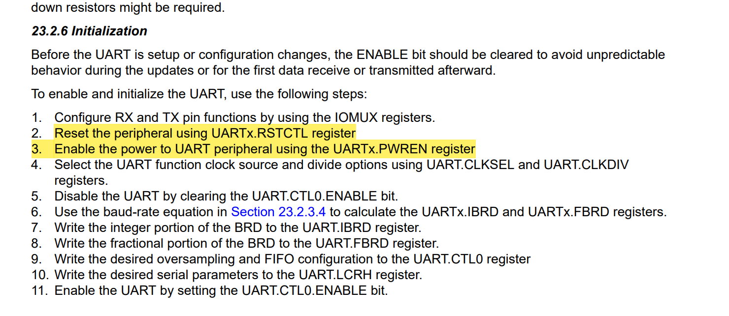

I had a customer point out to me that the UART initialization sequence is not fully complete:
If you follow this exactly and implement code it won't work because there needs to be a minimum 4 ULPCLK delay which is detailed in the PMCU section of the TRM:
Peripheral init sections should be complete and accurate so that customers have one place to reference for their code implementations.

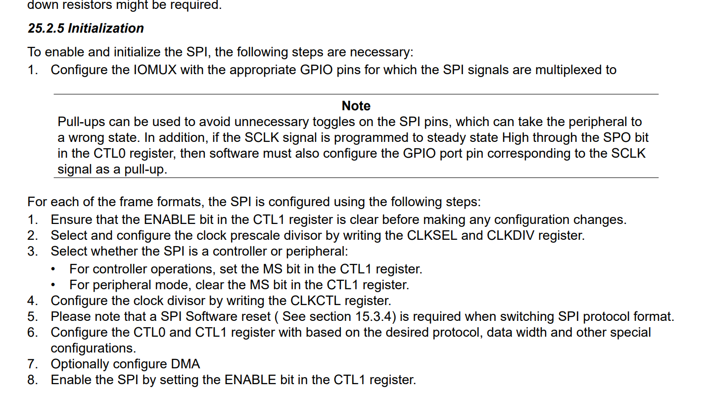

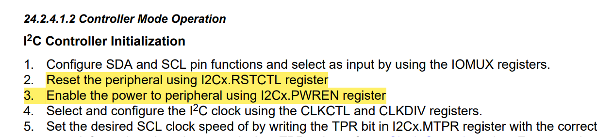

For example I2C also misses this:
The ADC peripheral doesn't even have an initialization section.
SPI doesn't talk about power enable at all:
Also, there are several more complex peripherals like the ADC and the timer where we don't even talk about initialization sequences so that's left as an exercise to the user to figure out.
