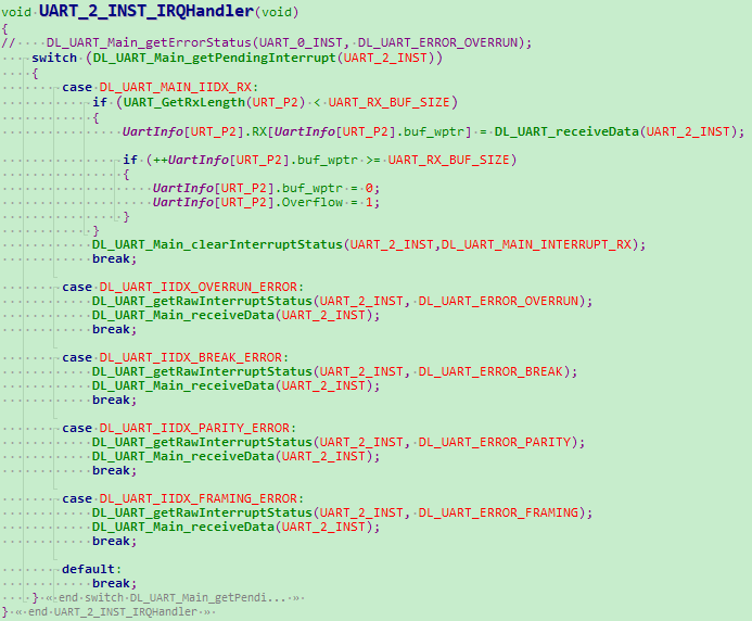

Here is our UART interrupt initialization and interrupt function:

  • Where (in your code) do you sample the EnabledInterrupts and EnabledInterruptStatus? Is it in an ISR or in Process-level code?
    At Process level (assuming the UART IRQ is enabled in the NVIC) it's effectively impossible to see this combination, since as soon as it happens the ISR is called and it clears the interrupt.
    The values of the (NVIC) ISPR[0] and ISER[0] might be informative.
    Your ISR seems to accept the "error" interrupts as well; are you enabling those?
    Unsolicited: I recommend you remove this line from the ISR:
    >DL_UART_Main_clearInterruptStatus(UART_2_INST, DL_UART_MAIN_INTERRUPT_RX);
    Reading the IIDX register already clears that status, so the only effect this can have is to lose a subsequent byte.

  • Thanks, we have removed function "DL_UART_Main_clearInterruptStatus(UART_2_INST, DL_UART_MAIN_INTERRUPT_RX)" in ISR, but the behavior still exist.

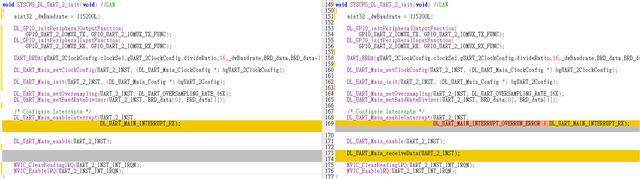

  • Short answer: In your DL_init function, some time before the NVIC_ClearPendingIRQ call, insert something resembling:
    > (void)DL_UART_Main_receiveData(UART_2_INST); // Read and throw away (and clear status)
    Longer answer: I was able to produce your symptom by clearing the UART IRQ while it was Pending. The peripheral (MIS) indicated the Rx interrupt, but the NVIC didn't know about it, and subsequently since the RIS bit was already set the UART didn't issue a new IRQ to the NVIC (aka "stuck").
    TRM (SLAU846C) section 3.3.1.1 (subsection "Setting and Clearing Pending Interrupt Status") appears to describe "Level" behavior for peripheral IRQs, but at least in this case (UART RX) the result seems consistent with "Pulse" behavior -- once the Pending state is cleared, it will not be re-issued.
    You could encounter this case if a byte were being received when you called your DL_init, and completed some time before the ClearPendingIRQ. (The floating point arithmetic probably expands the window here.)
    The usual workaround would be to explicitly clear the RX interrupt bit (RIS) before enabling it. But what I observed was that, while the receiver continued to operate, the RX interrupt still would not be raised (result: the RXDATA quietly overruns). This is presumably because the RXDATA hadn't been read.
    The step that finally cleared things up was to read the RXDATA register (in my case, I used OVRERR to do this). This also has the effect of clearing the RX interrupt bit. So I'm suggesting you just do this arbitrarily when you enable the interrupt.

  • Sorry, we have implemented the countermeasures you provided, but this phenomenon still exists.
    After conducting 200 stress tests, we discovered this issue again.
    The following is a record of the corrections we made based on the solution you provided(They are the initialization and interrupt handling functions of Uart2, with the original writing on the left and modifications made according to your instructions and code on the right). Please help confirm if there are any writing errors or if the countermeasures you mentioned were not imported correctly :
  • Yes, this is the workaround I was suggesting. It sounds as though this reduced the frequency of occurrence; maybe there's more than one way (not shown?) to encounter this condition.
    You should make a point to always read RXDATA for an RX or OVRERR interrupt, even if you throw away the result. My experiments indicated that failing to do this results in a similar (but not identical) condition. I see that both RX and OVRERR have corner cases (buffer overflow?) where RXDATA may not be read.
