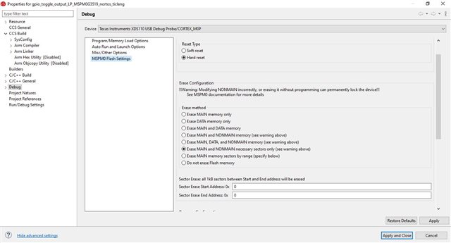

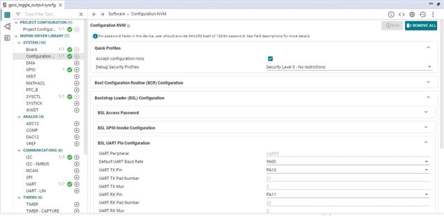

The boot operation functions correctly when using the default UART0 pins (PA10 and PA11). In TI CCS IDE, under SysConfig → NVM settings, we modified the default UART0 pin assignment to PA0 and PA1. Unfortunately, after making this change, the serial bootloader no longer worked. (Please find the attached screenshots image_1 and image_2 showing our configuration.)
In some cases, after changing the pin configuration and programming the device, the MCU appeared to become permanently locked, and we were unable to reprogram it using the XDS110 debugger (we are using the EVM as our debugger).
