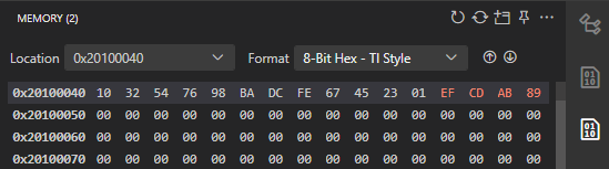

I took the sram_parity example and modified it slightly and stepped through the code to observe the memory regions as the data got written:

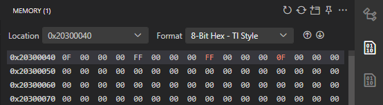

After the first write:
So what we see is that at 0x20300040 the parity bit gets written in the lower nibble, but then also gets mirrored at 0x20300044.

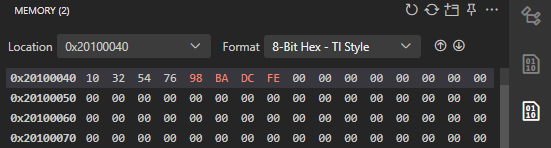

Then the next 32 bit write seems to write its parity bits at 0x20300044's upper nibble and again at 0x20300048:
And so on for the other two words:
