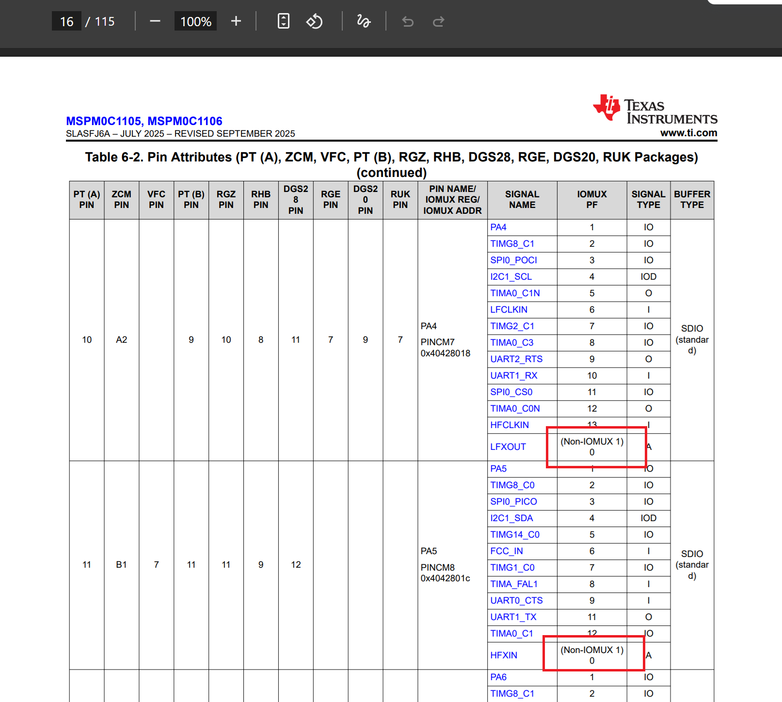

What does this Non IO MUX means in red of the datasheet below?

Usually analog function is not configured by IOMUX, so there is no IOMUX number for analog function
It will only affect the low level code of M0, and you can refer to MSPM0 SDK for the usage of different pin function.
