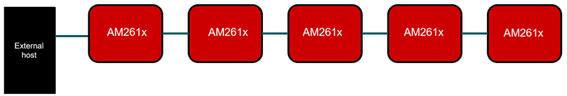

    Lets understand the sample implementation by using an example scenario.
    Consider a daisy chained ethernet topology, in which the external host sends packets to each node in the network. Each node in the chain responds back with the packet with modified VLAN Tag. The node-1 is connected to the external PC, but all the other nodes in the network require node-1 to forward the packets to the respective nodes. The responses from other nodes will also be forwarded back to host PC via node-1. In such a scenario, relying on Software for manipulating the packet fields for packet forwarding and switching will consume a lot of CPU resources. InterVLAN can be configured here for:
    1. Matching a packet based on the Destination MAC address and VLAN ID of the packet. This way, we can decide if the packet is to be forwarded to other nodes, or to be modified on this node and looped back to the host PC.
    2. If a packet matches the config, the packet sent out on Mac Port-1 will have the source and destination MAC address swapped, while retaining the VLAN ID. This emulates a case of CPSW Hardware packet loopback.
    3. If packet is to be forwarded to other nodes in the network via Mac Port-2, the packet fields are not manipulated and the packet is sent out as it is for other nodes.
    4. If the packet does not match any criteria, it can be dropped.
