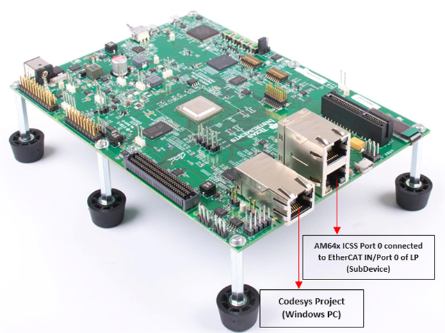

    Can I have more details on the topology you are testing here? Are you trying this in a redundancy setup ? Or is the PLC connected to the EtherCAT OUT port?
    Aaron
  • Hi Aaron,
    The Wireshark logs I sent were obtained using the following configuration.
    It is not a redundant setup. Nothing is connected to the LP's Out port.
    Best regard,
    Oyama

    Just to be aligned, are you connecting EtherCAT IN to Port0 and EtherCAT OUT to Port1(left open in your case)?
  • Hi Aaron,
    Yes, I've tried both ports and get the same results.
    Best regard,
    Oyama

    So I have brought up the Codesys setup on my side with RevPi Connect + as the PLC. Following are the configuration and topology:
    • SubDevice application: TI EtherCAT Simple Demo
    • Cycle Time: 1ms
    • SDK:  Industrial Communications SDK 11.00.00.13
    • Topology:
      • CODESYS Development System (Windows PC) <> RevPi Connect+ (EtherCAT Controller) <> ET2000 <> AM243x-LP (TI Simple Demo)

    On an additional note, we have verified the setup with AM64x as the EtherCAT Controller in the following topology:
    Codesys System Project (Windows) <> AM64x (EtherCAT Controller) <> TI ESC (running EtherCAT SubDevice Beckhoff Demo)
    With this, we enabled a script to continuously toggle between INIT and PREOP after reaching OP. Attaching the PLC_PRG and the wireshark log for reference: Codesys_AM64x_State_Transition.zip
    The above configuration ran for 30+ minutes and we haven't seen an instance where the state transition fails or the PRU halts after continuous state transitions.
    EtherCAT Controller Setup (AM64x):
    • 6.6 kernel RT image
    • CODESYS 64 3.5.21.40
  • Hi Aaron,
    Thank you for recreating the environment on AM64.
    Did you use AM64-evm or sk-AM64B? Is it a green board?
    Which port did you use for EtherCAT?
    The demo I use is not the Beckhoff demo, but the ethercat demo below with a 1h patch applied.
    sdk\examples\industrial_comms\ethercat_subdevice_demo\device_profiles\401_simple\am243x-lp
    If you are running a different program, please check again.
    Best regard,
    Oyama
  • Hi Oyama,
    We used the TMDS64EVM (green EVM board) for our testing.
    We've run the 401 Simple Demo from INDUSTRIAL-COMMUNICATIONS-SDK-AM243X 11.00.00.08 Software development kit (SDK) | TI.com. Attaching the wireshark logs for the same: Codesys_AM64x_State_Transition_TI_Simple_Demo.zip
    Aaron
