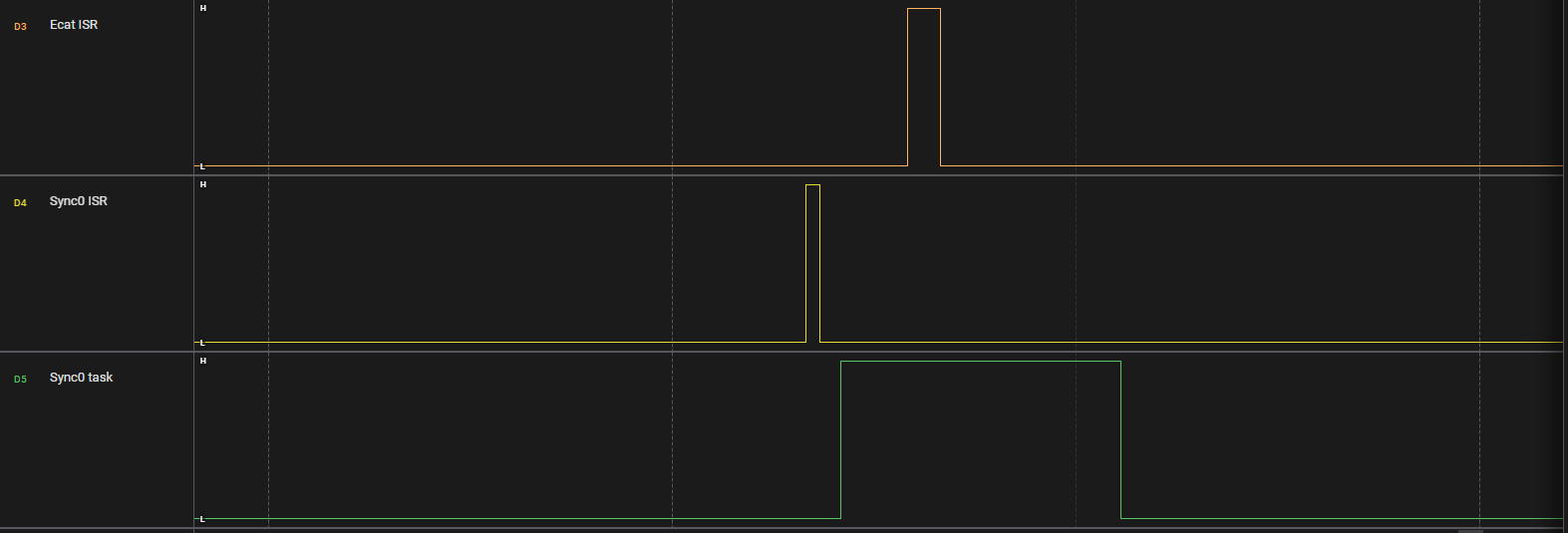

We recently encountered some issues with our EtherCAT product. Upon realizing they might be caused by race conditions on certain variables, we tested whether interrupts are truly disabled in the critical sections protected by bsp_global_mutex_lock.
We protected a section in sync0task so that Ecatisr wouldn't be triggered, but found that it was not blocked.

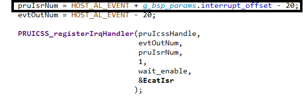

After going through the code i found that the interrupt number is as follows:

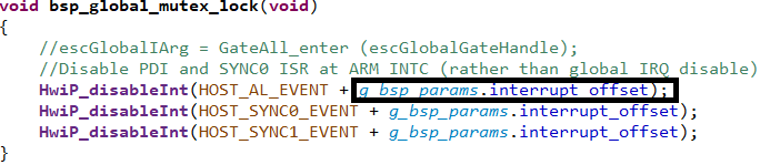

While inside bsp_global_mutex_lock, the interrupt numbers are missing the subtraction of 20:
when i substracted 20 from the interrupt number the interrupt indeed blocked.

  • Hi Sahar,
    I've created a high priority JIRA ticket to track the fix for the upcoming Industrial Communications SDK release. Substraction of Interrupt Number by 20 is mandatory for the mutex_lock and mutex_unlock APIs. Following is the implementation after the fix:
    void bsp_global_mutex_lock(void)
        //escGlobalIArg = GateAll_enter (escGlobalGateHandle);
        //Disable PDI and SYNC0 ISR at ARM INTC (rather than global IRQ disable)
        HwiP_disableInt(HOST_AL_EVENT + g_bsp_params.interrupt_offset - 20);
        HwiP_disableInt(HOST_SYNC0_EVENT + g_bsp_params.interrupt_offset - 20);
        HwiP_disableInt(HOST_SYNC1_EVENT + g_bsp_params.interrupt_offset - 20);
    void bsp_global_mutex_unlock(void)
        //GateAll_leave (escGlobalGateHandle, escGlobalIArg);
        //Enable back PDI and SYNC0 ISR at ARM INTC
        HwiP_enableInt(HOST_AL_EVENT + g_bsp_params.interrupt_offset - 20);
        HwiP_enableInt(HOST_SYNC0_EVENT + g_bsp_params.interrupt_offset - 20);
        HwiP_enableInt(HOST_SYNC1_EVENT + g_bsp_params.interrupt_offset - 20);

    The reason we are seeing the issue with this specific controller is due to the fact it sends the PDI's very close to the Sync0 interrupt, which causes the PDI interrupt to sometimes arrive while Sync0task is executed.
