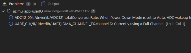

We are using CC20.3.1 with TI clang 4.0.4 and we are compiling a program which contains errors, but the errors are not displayed in the console or in the problems tab.
One of the errors we have is, for example, the use of an undeclared function.
  • I removed all confidential parts from the compilation chain.
    What I noticed is that there's the following option, which we haven't enabled: -Wno-error=implicit-function-declaration
    Is this normal?

  • We tried with CCS version 20.02.00 and TiClang 4.0.3, and the errors are clearly visible in the problems tab.
  • After various tests, it appears that errors are not displayed if there are too many of them.

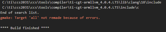

  • We managed to correct our errors.
    We reverted to CCS20.2, which correctly displays all compilation errors, unlike CC20.3.
  • Here is an example of an error that is correctly reported in CCS 20.2 Ti Clang 4.0.3 but was not present in CCS 20.3 Ti Clang 4.0.4.
    In this scenario, we deleted the configuration element, but it wasn't removed from a structure.
    Therefore, an error is expected, but it's not displayed in CC20.3.

    I already explained this in this message. You create a structure, for example:
    typdef struct
        uint32_t element_1;
    }sStructTest;
    You are instantiating it with an element that does not exist:
    sStructTest structError = {.element_1=0, .element_2=0};
    At this point you encounter a compilation error, but no information on the type of error.
    This is a known issue with CCS 20.3.x: https://sir.ext.ti.com/jira/browse/EXT_EP-12940
    We have fixed the issue in the upcoming CCS 20.4.0 release targeted for the end of this month.
