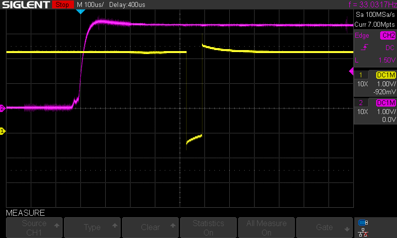

After reboot, and configurations, the initial pulse nominal high output and pulse low is wider, yet we do not understand why.
red trace is nRST, and the yellow trace is the PWM output (which is supposed to be 32uS). Here it is 64uS. The remaining pulses are correct.
Any Ideas? Thanks for Your attention and reply! and Help!
  • using TIMG0, pin 32 of the Launchpad

    How do you output this pulse (expected 32us)? Do you try to use a PWM function or just toggle GPIO in a interrupt?
    And could you point out which stage in your waveform that MCU is in a standby mode?
  • it is the PWM function.
    the PWM count and trigger is setup in syscfg....
    the below code is after setting up GPIO, SYSCTL, RTC and I2C.
    This is before the WFI in the While.....

  • Hi Roger,
    The GPIO enable output should be placed before start counter, to make sure the GPIO is ready for output before counter starts. And also make sure you do not check "Start Timer" in your Sysconfig.
    Besides, which clock do you use as TIMG0 source clock? LFCLK or BUSCLK? Notice that all high frequency clocks except LFCLK will be disabled in Standby0 mode. So you need to use a LFCLK in this case.
    And could you also try whether the pulse width normal if you try to test in debug mode?

  • Hi Roger,
    One difference is that MCU may not enter low power mode (standby mode) well in debug mode. For the free run mode, you just need to power on MCU and let MCU run itself without debug access.
    Have you ever try to change the PWM period of the pulse? Is it always 2x relationship between the expected value and measured value?

  • Hi Roger,
    So sorry for late reply.
    What you said could be a workaround. Since the pulse is generated by PWM module and the generation time is predictable。
    As for this issue, are you using a center aligned counting mode or a up or down counting mode?
    Could you share you Load value setting by sysconfig, and the load value when you update counter in your program?
    I suspect maybe the initial load value is different from the reload value. (if you could always see the first pulse is twice of expected time)
