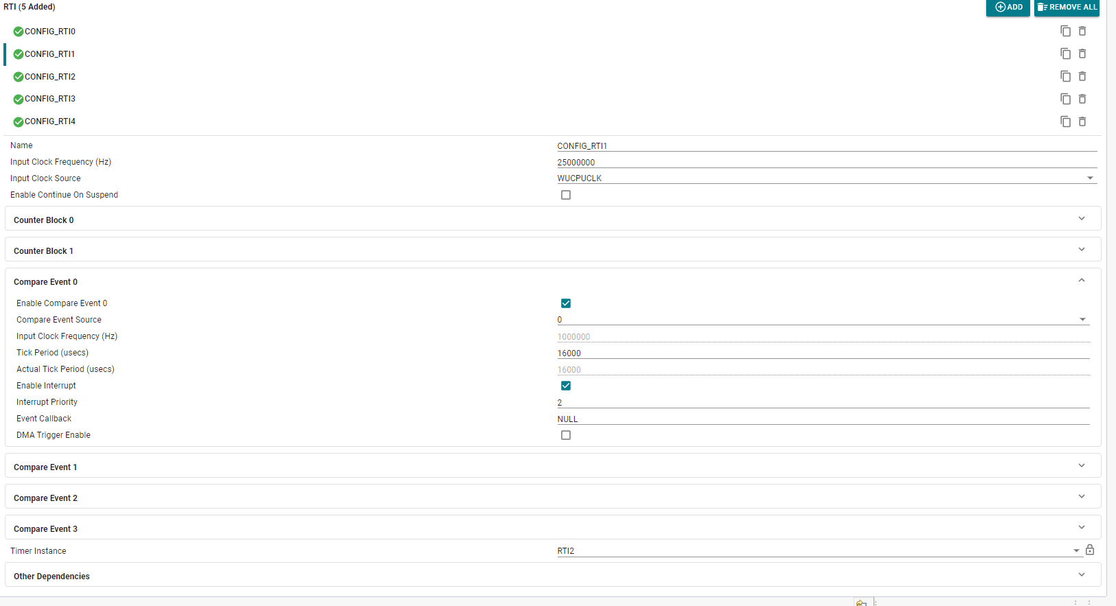

as per our requirement we need 5 type of timers, previousely we used RTI0 with 4 comparators and RTI1 with 1 comparator. but now we planned to use RTI0, RTI1,RTI2,RTI3,RTI4 (1 comparator).
Issuses:
  1. RTI0_isr() and RTI4_isr() only enabling and other timers are not enabling.
  2. we open the RTI channels, enable the RTI timers. Even though we could not able to create the interrupt on RTI1_isr(), RTI2_isr() and RTI3_isr().
  3. Is that possible to use different RTI timers?
herewith attached the config as below,
these are the above configuration done and we have got below code which generated by the CCS,

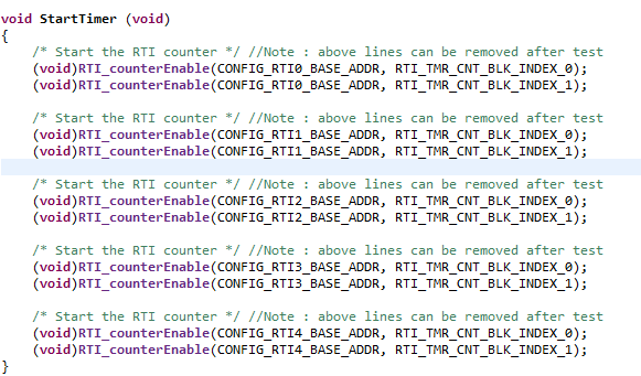

and we are enable the  RTI timers as below,
here are the things have done in the code, but not working, can anyone guide in this?

  • Hi Karthikeyan,
    I have a few questions:
    1. I see you have configured RTI1 and RTI2 in two different configs.The AM2634 device only has 4 RTIS (RTI0..RTI3), Do you intentionally wish to override the initial configs and create duplicate ones?
    2. Can you please explain the below point?
    3. You have not specified the interrupt callback functions in RTI configs. Can you define that? Please refer the RTI LED blink example in the SDK and refer the example.syscfg,
    It is indeed possible to use different timers in the application. Just make sure you handle the priorities efficiently according to your application's use-case.
    Shaunak

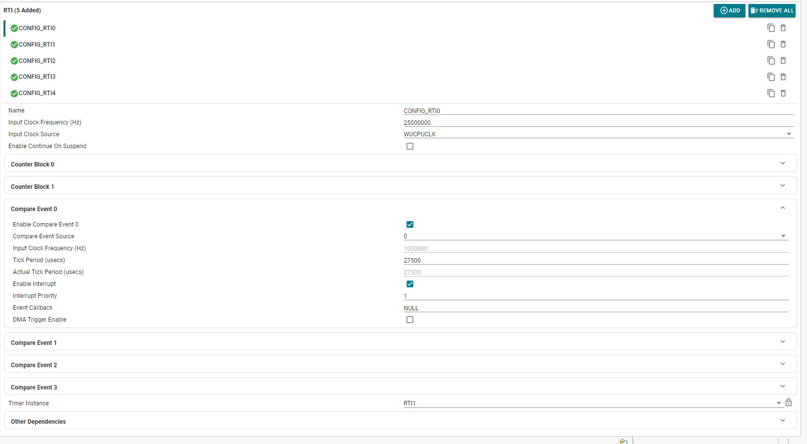

  • Hi Shaunak,
    answers to your questions:
    Ans: i want to create 5 timers and CCS config used the RTI1,2 and 3.
    Ans: CCS config created isr Callback as RTI0isr(),RTI1isr(),RTI2isr(),RTI3isr(),RTI4isr(). in that RTI0 isr() and RTI4 only hitting.
    Ans: priorities are handled as per attached code.
    Ques: i need 5 timers and how i can configure it??
    thanks,
    Karthikeyan.S

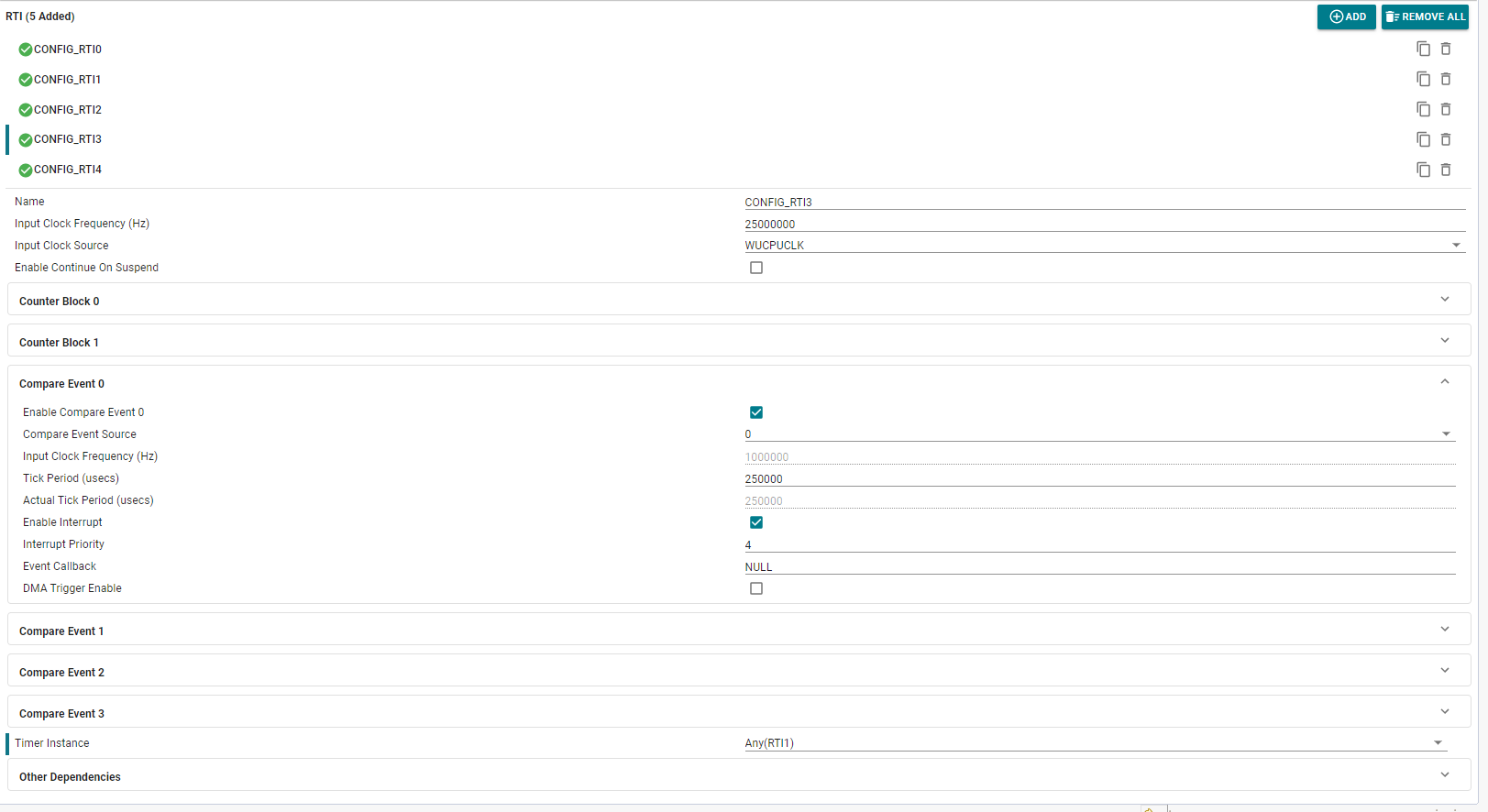

  • Hi Karthikeyan,
    Since we only have 4 physical RTI timers on the AM263x device, you can only configure 4 RTIs (RTI0, RTI1, RTI2, RTI3). You cannot configure 5 independent timers on the device, since the device only 4 RTI timersEither you will have to use the timers of RTI separately (which i see you were doing before) OR
    Other than this, you have 4 watchdog timers. If your use-case can rely on the watchdog timer, you can use that and keep servicing the watchdog. Internally, the RTI and watchdog IP are pretty similar in function.
    Shaunak
  • Hi Shaunak,
    1. Thanks for your quick response, i would like to use RTI timers only. but the timer instance available in configuration is RTI1, RTI2 and RTI 3 only.
     Here.
    2. I have one more doubt, should i enable the counter block in every timer. Like in RTI LED Blink example SDK.
    3. Sometime our RTI timers interrupt is not enabling, and other timers (comparator) is working. What could be the reasons and how to avoid / restart.
    Thanks.
    Karthikeyan.S
  • Hi Karthikeyan,
    1. RTI0 is blocked by the clock module (tick timer).
    2. This is not changable (one RTI has to be allocated to systick/heartbeat)
    3. This is a bit weird. As long as you ensure priorities are different for all Timer interrupts, it should trigger interrupts independently. I'll need some more details to understand this. Can you share your project as a zip please?
    Shaunak

  • Hi Karthikeyan
    There is no such project in the SDK which uses all the timers. It should be pretty straight forward to create such an example but right now i don't have the bandwidth due to internal development activities. Can you follow the procedure shared in my above replies and try creating such an example?
    You just need to add all RTI instances, make sure the syscfg has all the required parameters (priorities, counter and compare blocks set, ISR callback), it should work.
    Alternatively, do you mind sharing what is the exact application that requires 5 different independent timers.
    Also, on other note, since you have a requirement for 5 independent RTI timers, have you considered the AM263Px device? It has 8 RTI timers and the device is pretty much the same, rather an enhanced version of the AM263Px, with some packages being pin to pin compatible.
    AM263x (what you are using): https://www.ti.com/product/AM2634
    AM263Px: https://www.ti.com/product/AM263P4
    I know just migrating for a missing timer is something that you wouldn't really consider but i wanted to share the details in case you find the other device suitable as well.
    Shaunak
