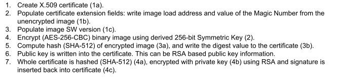

I am able to create the X.509 certificate by following the procedure described in the AM263Px TRM. However, I am unsure how to encrypt the application image or SBL image and how to add them as described in the procedure.
I have the following questions:
  1. What exactly is meant by creating a certificate, creating an X.509 template, and creating an X.509 certificate? How do these differ in the context of the image-generation flow?
  2. The SBL image is encrypted using mcu_rom_image_gen.py. How is the application image supposed to be signed or encrypted?

    I am attempting to generate an X.509 certificate manually from the command prompt using two methods, as shown in the attached images.
     Method 1 – No errors (certificate generated successfully)
    Method 2 – Errors while generating the certificate
    I am using the same input files in both cases, but the certificate generation fails when I provide the file paths instead of placing the files in the current working directory. Could you please advise what might be causing this issue?
    Additionally, I have a few questions:
    1. This process is intended to run in the post-build steps. How can I resolve the errors that occur when these steps are executed automatically in the build pipeline?
    2. I am generating the certificate in .der format. Is this acceptable, or must the certificate be generated strictly as TIIMAGE format? Would using .der cause any issues?
    3. The certificate contains a Validity field. Does this field impact secure boot or operation after expiration? In other words, will the device stop booting after the validity period ends, or is the expiration irrelevant since the controller has no real-time clock source to verify the date?

  • Hi Shashank, please see that the file directory error can happen, due to path representation with /(forward slash) vs \(backward slash)
    Can you try the alternative path and use double quotes around the path
  • This process is intended to run in the post-build steps. How can I resolve the errors that occur when these steps are executed automatically in the build pipeline?
    This also looks to be related to path issue, please try the previous suggestion.
    Please use the .tiimage format; we do not recommend any other format.
    The ROM does not checks the certificate validity field.
